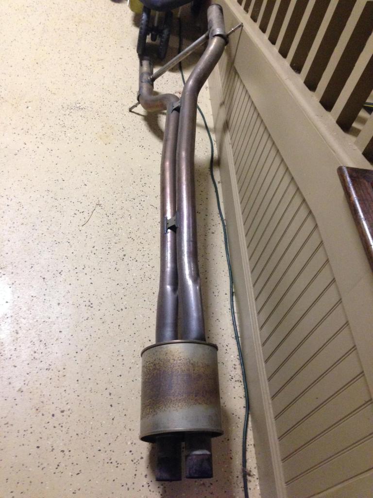

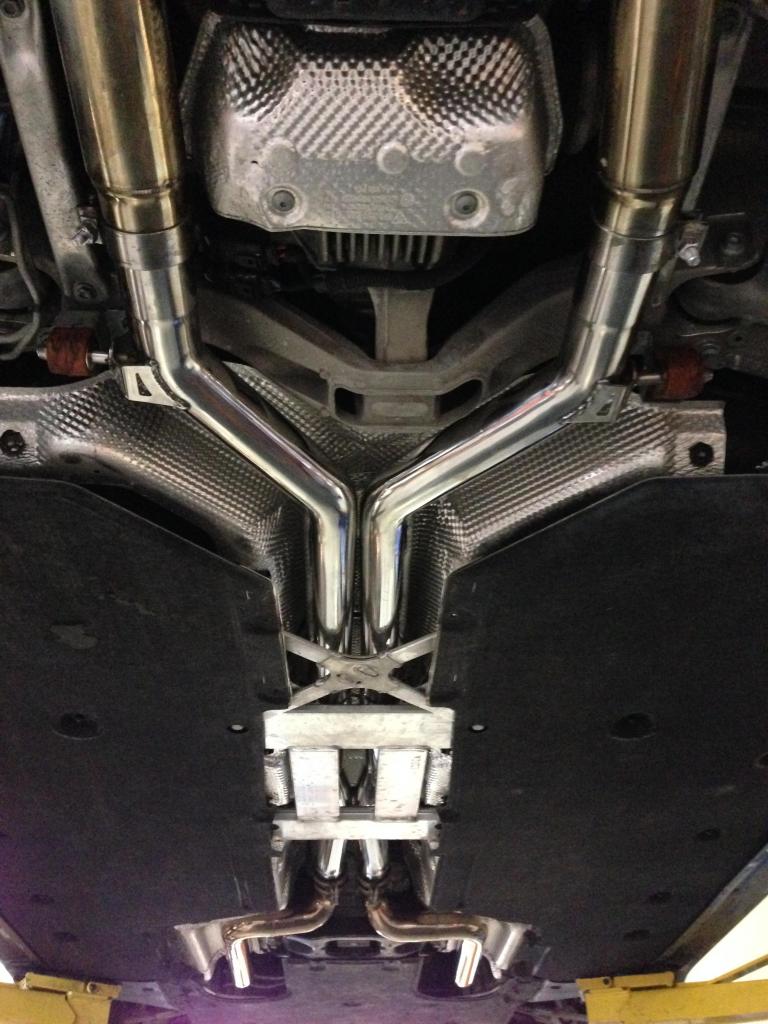

Remember my setup is a full system that includes the Fabspeed downpipes with 200 cell cats, the Fabspeed xpipe (that removes a huge resonator) and then the axel back Meisterschaft GTC exhaust so this may be different than what you are considering. I can tell you it’s an amazing sounding setup as I get continual complements related to how the car sounds… total beast mode.
With this setup the following resonator (pretty huge) is removed:
To look like this:
My findings are this… With valves open, there is somewhat of a cabin hum at the very low RPMs (from 1-2k) with 1.4k-1.5k being the most noticeable (but still isn’t really enough to bother me or my wife as the sound is more exhaust tone and less just a “drone”). This is less noticeable in these very low RPMs when you close the valves but still is somewhat present.
What this translates into is if you drive the car in regular mode (non sport or super sport), the car will hover in these very low rpms at cruise and produce these results. That being said, I almost always drive in sport mode and sport mode introduces rmps at the low end over at 2k+ where really any hum or drone in the cabin is not present at all (just full on sound of an amazing engine and exhaust).
With just the Meisterschaft GTC (axel back portion), and keeping the stock downpipe/ mid pipes there of course could be varied results as you are getting close to a strait pipe cat system and removing a huge resonator with the xpipe if you go with the full setup similar to what I did.
I am extremely happy with the results / the sound of my pani but different strokes for different folks. Some may not want to consider the fierce ground shaking goodness that this car can produce… (I'm absolutely hooked on driving through tunnels with this setup)
