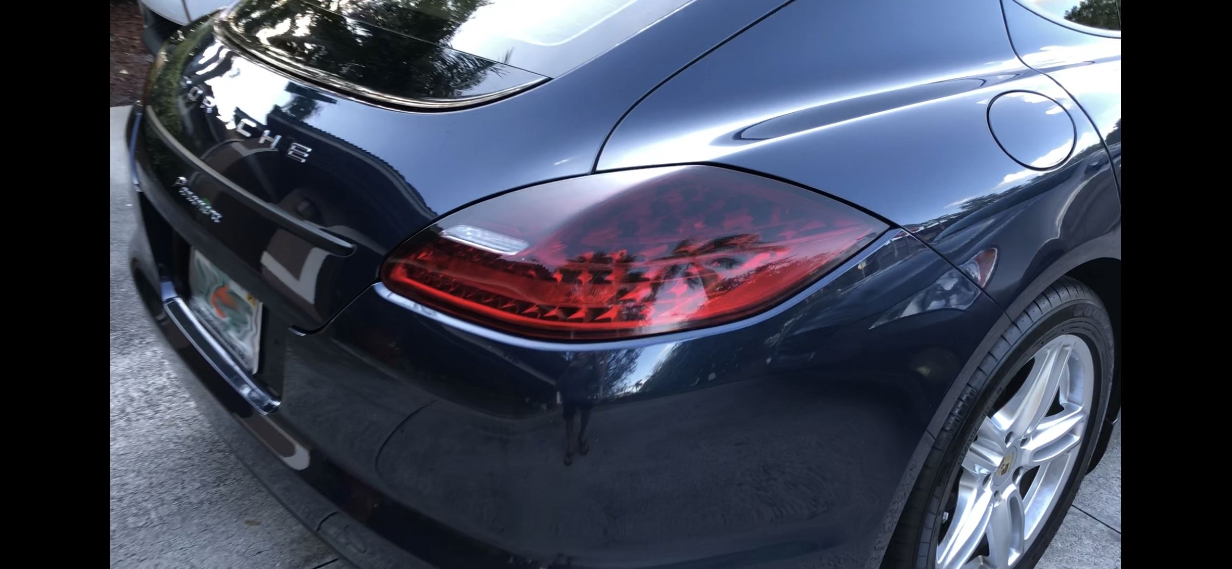

I did my '13 Panamera in 3 steps:
1. Tinted clear area red
2. "Faded" smoke from top to bottom (almost nothing at bottom & masked off the back up light)
3. Clear coated entire lens
Has done wonders at reducing the "big ***" effect, looks cool yet classy & custom and in the day light its looks killer because its not 100% smoked out...
This is the best overall pic and how it looks in day light...
Getting towards dusk, so when lights are on, color seperation seems more drmatic

Did you tint them yourself? (Nice flip flops)
Old Feb 19, 2018 | 06:26 AM
CIMMA's Avatar
Joined: Feb 2017
Posts: 3
From: south florida
CIMMA is infamous around these parts
Yes, tinted them myself with VHT and spray clear coat. Trick is to allow the spray to warm up a bit so the spray mist is finer, also, I put on 6 coats of clear and then wet sanded and polished and waxed ALOT! Its not as easy to do the fade, if I was to do it again, I would have a pro spray them for me.

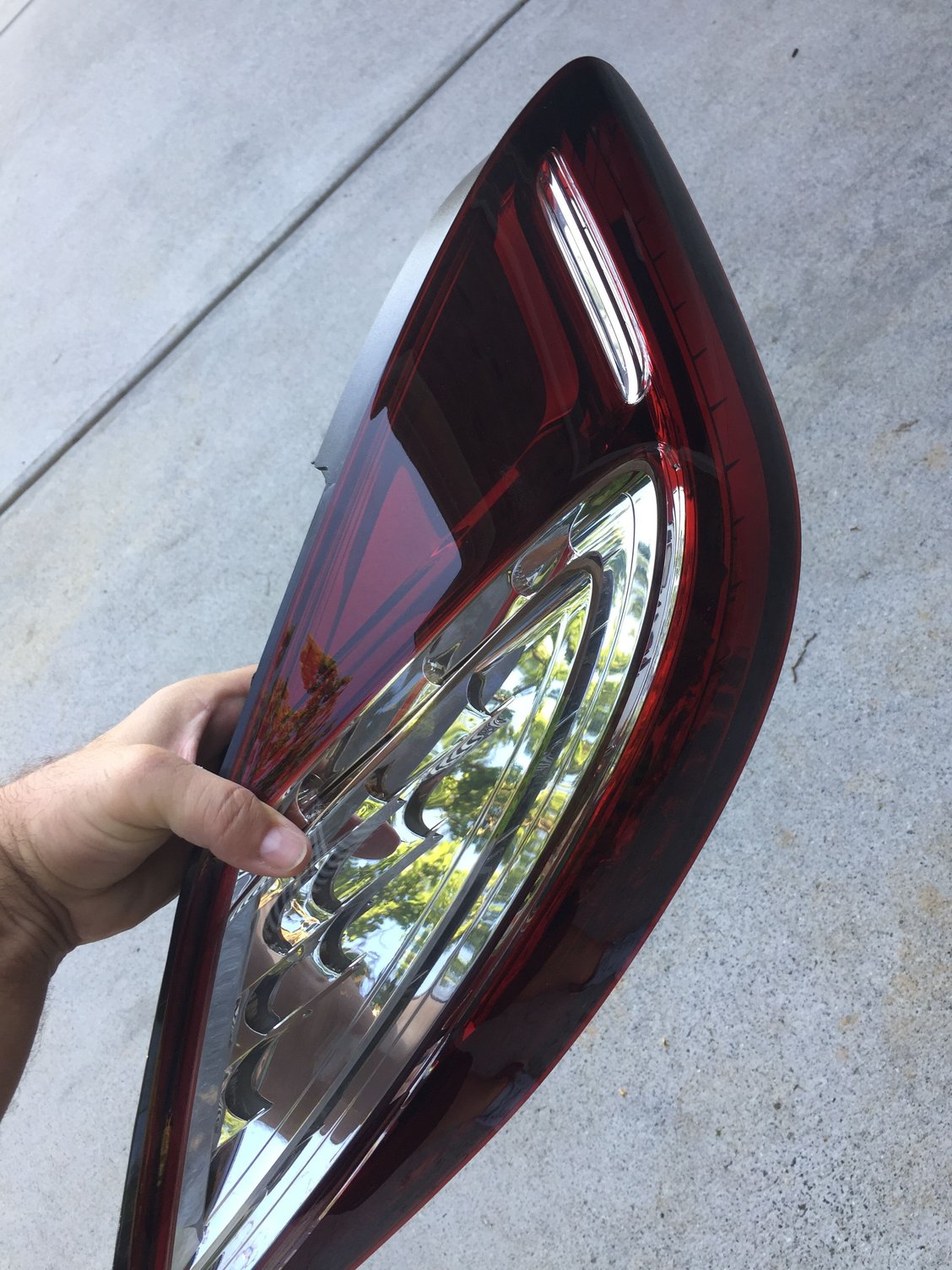

I went with VVivid Air-Tint Smoke Black Gloss when I did mine, fairly easy to do (had my 9 year old daughter help me)

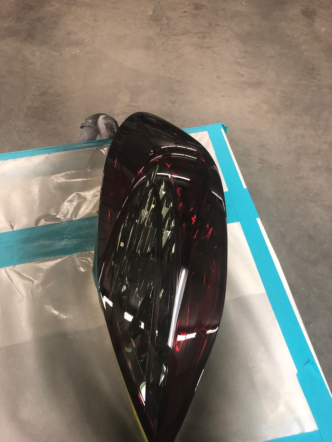

I did vvivid and came out like so:
