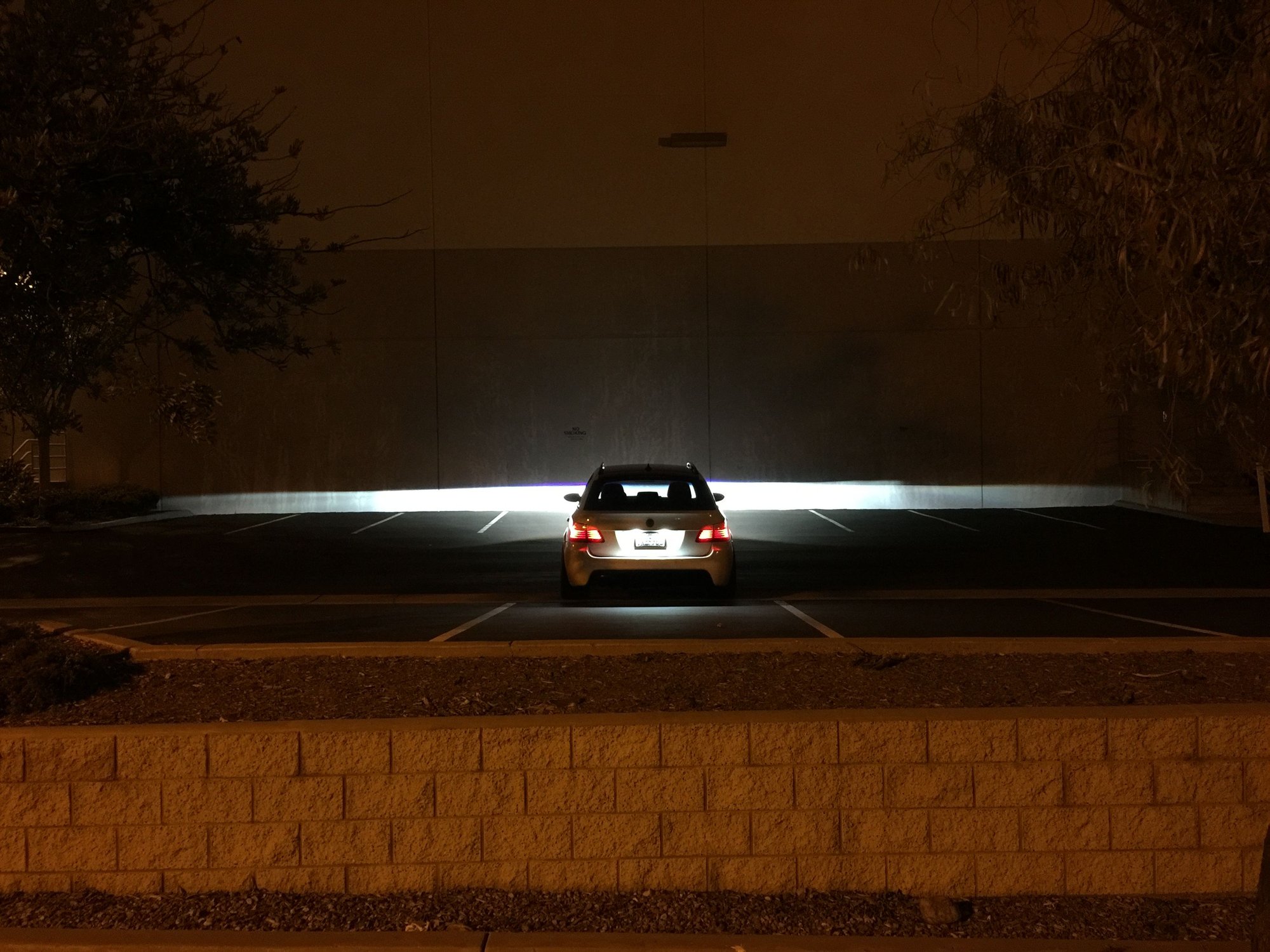

People assume by default that the newer technology is better (as it should be) but that really isn't the case the LED vs HID headlights ....yet. There are good and poor examples of each technology but in general HID is still supreme big picture and will be around for a bit longer. LED will have a prominent role in automotive lighting for many years to come due to the efficiency and small footprinted required for a light.
LEDs are superior due to the flexibility offered by the small size, you can easily fit 10+ LEDs in a headlight and easily create a "dynamic" output simply by selecting and deselecting individual LEDs. The best example of LED technology on the market is the new Mercedes multi-beam which stuff 84 small diodes behind a projector lens in each headlight yes, ~170 LEDs for the headlights which give a great amount of lighting resolution and control.
HIDs are superior for light intensity. LEDs have a hard time matching the intensity and overcoming thermal challenges. A HID bulb will put out roughly 3,000 lumens and there are plenty of LED light bars and offroad lights which can easily beat that but none of them can put that kind of power out and be small enough to fit in a headlight and meet DOT and NHSTA requirements.
The reality is most of the new LED headlights are not all that great but people get excited over the "tech" and the blueish white output but the actual performance isn't up to snuff. Personally I don't have any first-hand experience with the Porsche LED units but with the exception of some Acura models, most LEDs are sub par. LED headlamps from Toyota, Nissan, Tesla, Hyundai, Ford, BMW, Audi etc. ..all quantifiably dead average to poor.
The other benefit that HID currently has over LED is the the components are modular which can be swapped and upgraded. You can take a HID headlight a retrofit another projector to better suits your lighting needs and then you could replace the stock 35w ballast with one which is 40w - 75w if you felt so inclined. LEDs can't do this. In some cases you can modify the driver and extract more power but the output is only marginally increased and you also amplify the thermal issues.
I do a lot of tinkering with headlights, here are some examples of current LED projectors vs HID projectors... projectors are HID unless specified "LED."
Here are some photos showing the potential of HID...

If you are looking for HID performance it would be much easier just to swap the headlights from LED to HID and then retrofit the HID headlights with better components. I know you said you did not want to do this but the way you are describing it of retrofitting HID components into the LED headlamps will be extremely challenging.
For parts The Retrofit Source is the go-to for aftermarket HID components. I don't think I can link the website so just google the name.
The new LED lamps have complex modules and it may be hard to get the HID components to operate properly, there will also likely be many errors which will arise due to the monitoring CANBUS system (I assume Porsche implements this). Lastly, it will be challenging to mount, properly aim, and make the headlight look clean and OEM with in terms of fitment.
Lots of challenges but if you want to tackle such a retrofit more power to you.

With projector retrofitting, swapping bulbs and ballasts HIDs are easier to swap and manipulate and modify to suite the application. With LEDs, especially modern systems like PDLS+ and other adaptive/dynamic LED headlights, beyond altering some code to make the program "smarter" there isn't much that can be done to improve the output, essentially the LED systems are fixed where HIDs offer more options being modular and less dependent upon sensors and computers for operation.
That being said a system like the PDLS+ LED headlights is as good as it will get aside from some software tweaks. Compared to say my personal HID system where I can pick and choose the projector, bulb, and ballasts for my application I have more choices and I respectfully disagree about the high speed intensity part, that is where HID shine and I would gladly put my personal HID headlight setup against any modern LED system to measure intensity.
Using the Panamera as an example, from the factory the LED might trump HID but you can modify HID where you can't with the LED.
Below are some pics of my current HID setup I strongly believe modern LED headlights would have a hard time producing output like this.
Evan
