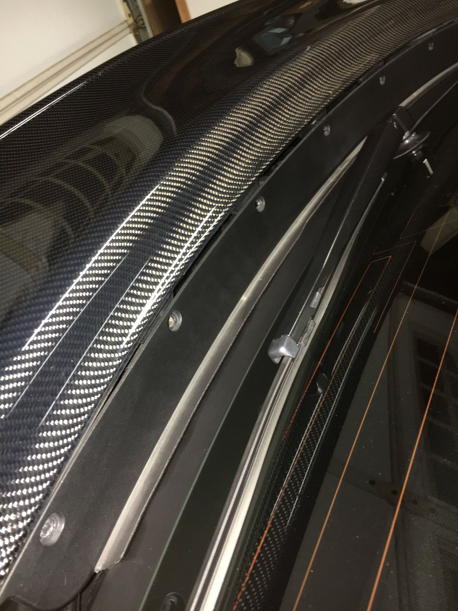

Hi OEkun1 and ArneR -
I just got my spoiler from Yachant2011 on Ebay which i believe is the same company that makes both of your spoilers. Quality of it looks really good. Unfortunately, the fitment is not so great. Did you guys have to do any additional work to it to have it installed (besides drilling the holes on the front side tabs?) Those tabs doesn't seems to butt up against the screw holes. Also, the middle section doesn't seem to seat flush like the two ends. Also, did you guys get new clips and screws or somehow reused the stock clips and screws?
I really don't want to take my car to a body shop if this is something I can do myself. Please help if you guys have seen these problems during your installs.
Thanks!

Mine was identical. You just have to be a little tough and push it down on the middle so the spoiler go flush with the spoiler insert. Then drill the holes. I just used all original clips and screws. I did it alone, but two person would be good. One pushing it down,and the other making the holes. Good luck.
ArneR, thanks for the reply. It sounds like the carbon fiber spoiler will flex a bit right? I was worried that I might break the mechanism of the spoiler or crack the carbon fiber with too much force. Did you remove the entire spoiler mechanism first or just did everything while it is attached to the car?
Also, how did you get the clips to fit? The tabs on the carbon fiber spoiler seems to be quite a bit thicker than the stock spoiler.
Hope I can get it turn out as nice as your.....

Thanks to ArneR, I was finally able to put the spoiler on. Following ArneR's advise, I stopped being a little girl and just used some force on the spoiler. The tabs on the spoiler was a little too thick for the stock U-clip so I had to sand it down a bit. After that it was smooth sailing. The entire install took only about a hour (+ a day of being a p***y)

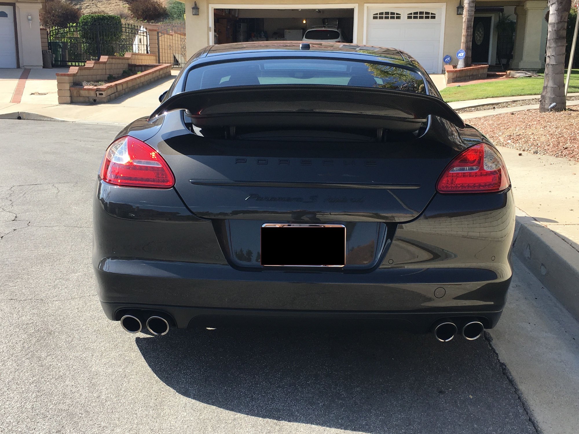

Originally Posted by Evil Sports
Im on the fence here. It looks great and think it would pop on my white 14 4S but I feel like it removes some of the class of the car having the fixed spoiler. OG99 how about some more pics
ES, I know what you mean. I was on the fence too until I saw the photos posted by OEkun1 and ArneR. I guess the question is what kind of look are you going for. There are definitely more subtle aftermarket spoilers out there. For me, I've always felt that there's something missing in the 1st Gen Panameras. This spoiler helps fill out the back side and give the car a little bit more aggressive look. What sold it for me was the fact that I get to keep the functionality of the stock spoiler, keep all my emblems where they are and fairly easy to convert back to stock if I ever wanted to.
Personally, I feel that when the spoiler is deployed, it sits a little too high but it doesn't bother me too much. That's personal preference, some people like it and some don't. My spoiler doesn't come up very often anyways because i'm always sitting in LA traffic.
Here are some more photos. Hope this helps.
Spoiler down-
Spoiler up-
