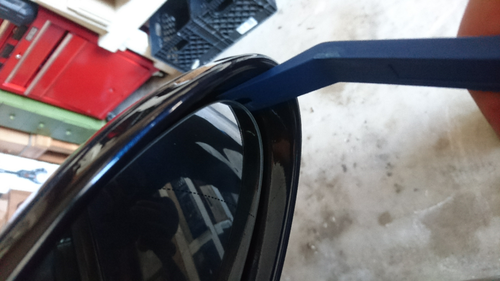

Grab a door panel pry tool. I purchased a set of pry tools from Harbor Freight. You will want to adjust your mirror so that it's as far out as it will go towards the outside end of the mirror. Simply put your pry tool behind the edge of the mirror and apply consistent, even pressure. The mirror will unlatch from the motor mechanism.

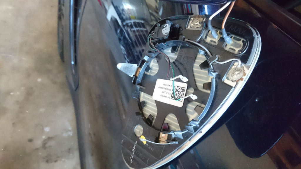

Step 2. Remove the heated mirror power terminals and plug for auto dimming mirrors, if you car is so equipped and remove the mirror completely.
Step 3. Grab the new aspheric mirror, attach all the electrical connectors.

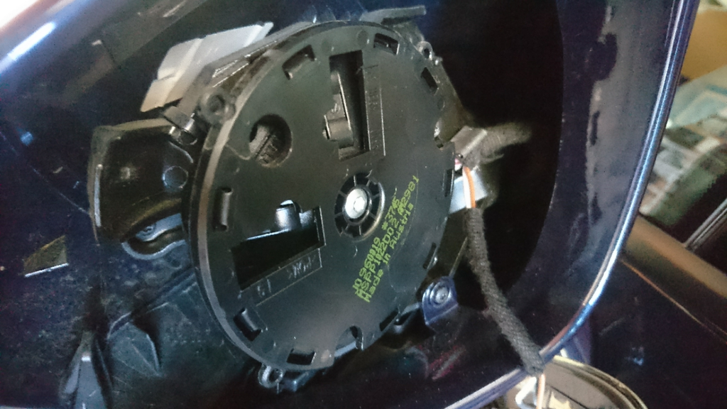

Step 4. Apply firm pressure to the mirror to enable it to attach to the motor mechanism.
