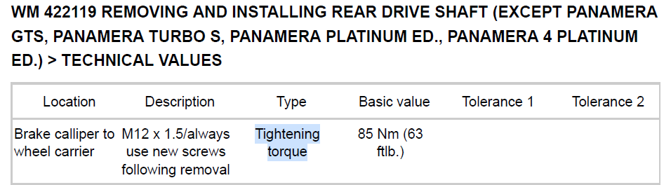

Can anyone let me know torque spec for Panamera (2016, 970.2) for front and rear brake calliper bolts?
What I found from some previous threads (970) were 104ftlb for front and 63 ftlb for rear, but they came from 970, not 970.2, so I would like to check before my brake works.
Thank you for your answers in advance!

such a pain to search this stuff in .pdf. those are correct torques see below:
WM 433019 REMOVING AND INSTALLING FRONT AIR-SPRING STRUT (EXCEPT
PANAMERA EXECUTIVE, PANAMERA GTS, PANAMERA TURBO S, PANAMERA 4
EXECUTIVE, PANAMERA PLATINUM ED., PANAMERA 4 PLATINUM ED.) >
REMOVING AND INSTALLING AIR-SPRING STRUT > INSTALLING AIR-SPRING
STRUT
Brake calliper to wheel bearing housing: Tightening torque 140 Nm (104 ftlb.)

Make sure to use new bolts too as they are not reusable.
