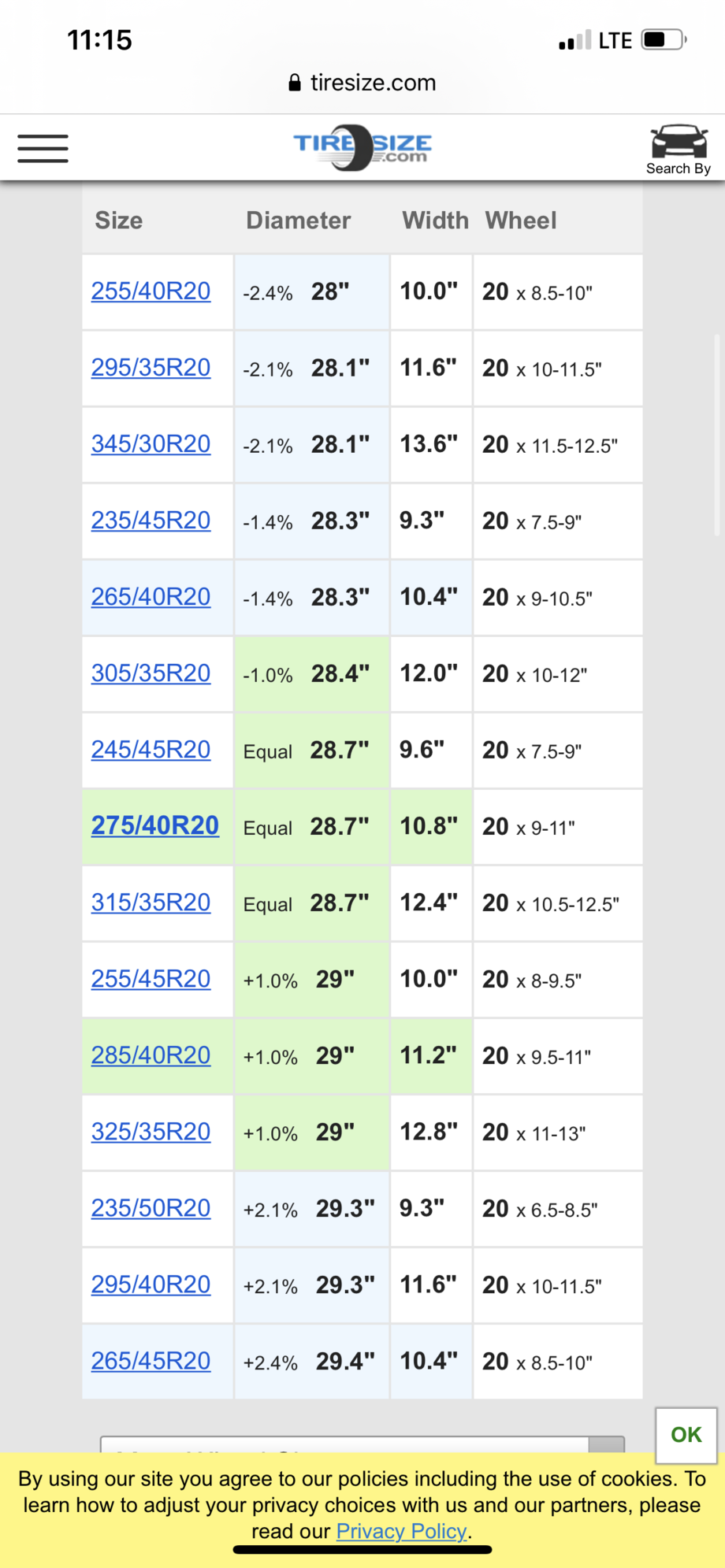

see the chart as to compatible sizes, it is important to keep the same OD because of the AWD system! Rule of thumb is within 1% is ok, personally I’m not sure how Tolerant the Porsche differential is.

I completely agree the tire size calculator on www.tires.com shows 275/40R20 and 315/35R20 match up perfectly in height/circumference. Just don't want to possibly misinform the one asking that it fits. I'm also interested in this size as Atturo AZ850s come as runflats in this exact size combo. (Won't need tires for a while with the tread left on ours though)....
