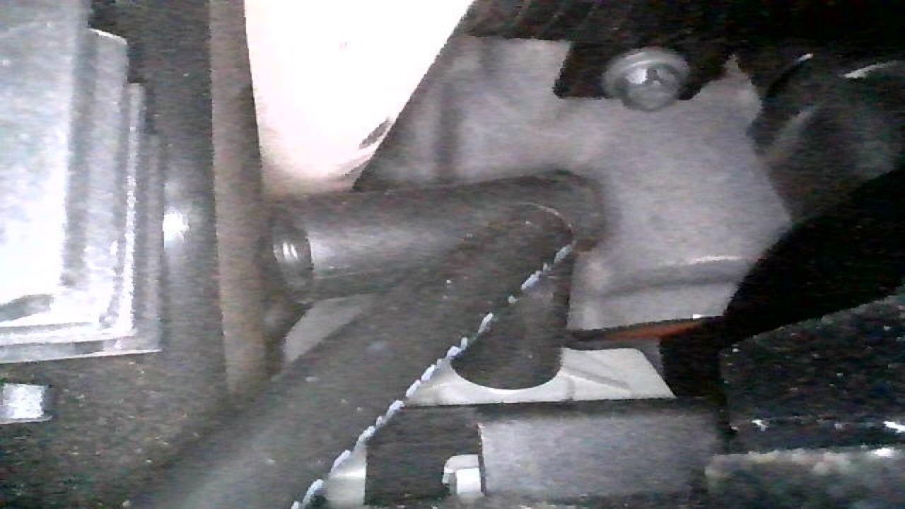

I purchased a bore scope and found the rear vacuum line on my intake manifold had popped out of the rubber housing. The car ran rough and gave a P0455 code. I decided to finally tackle this job...again. Here are a couple of lessons learned:
The rear vacuum line in a 2010 4S likes to pop out of the rubber elbow. I tried multiple times, but could not get it to stay in the elbow. I decided to use a small ziptie to secure it the the elbow, then insert the other end of the elbow into the nipple. This worked! Here is a photo of the vacuum line I am referring to with the ziptie:

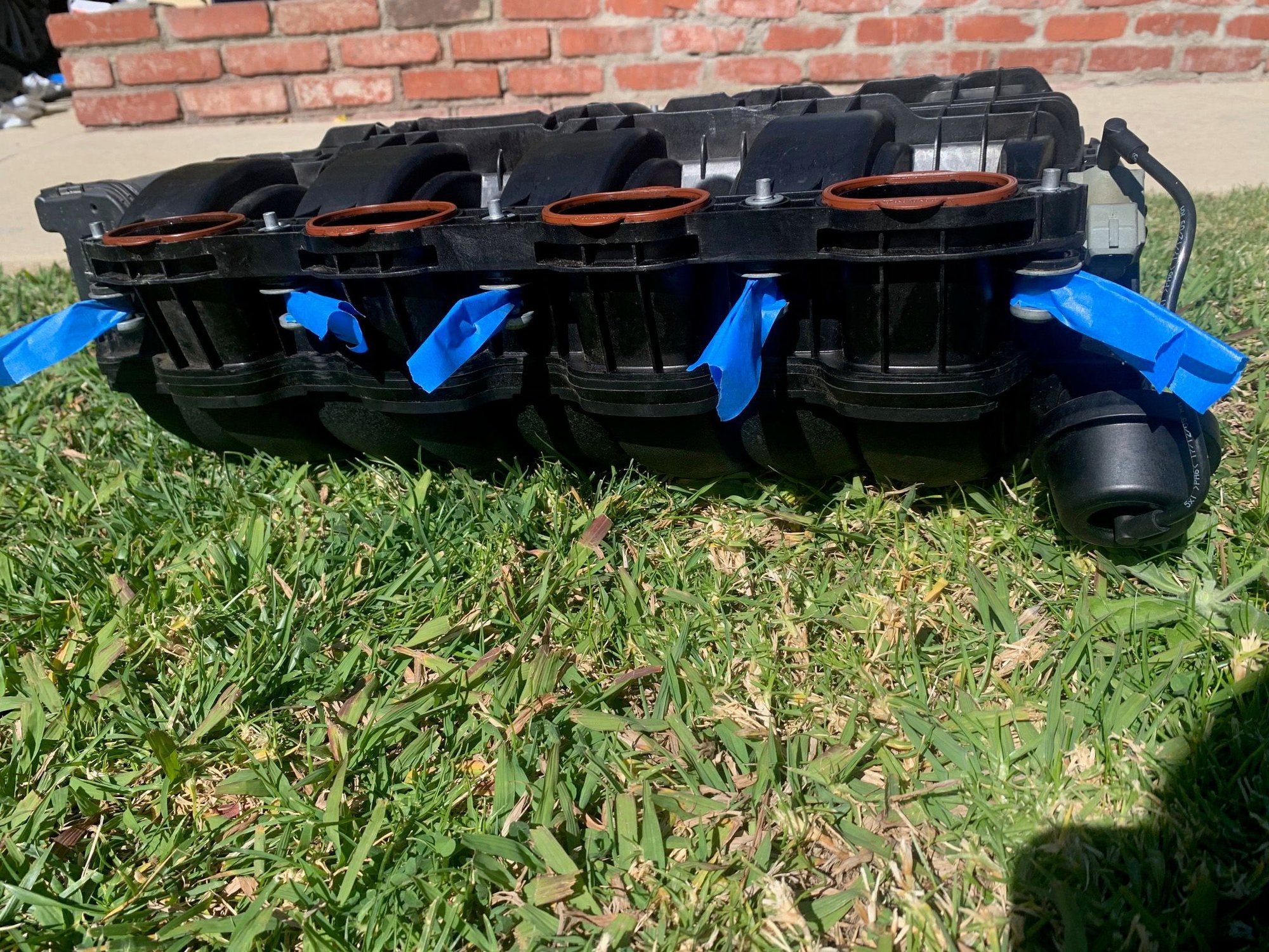

Also, the intake manifold bolts are retained by a metal clip into the manifold. When maneuvering the manifold into its proper place, gravity allowed the bolts to drop downward making it difficult to precisely position it in place without dislodging the vacuum line. I used 3M painters tape around the threads to keep them from falling due to gravity and once it was in place, I removed the tape. The attached photo shows it upside down after I placed the tape on each bolt. It worked very well and the job was successful!
Thanks everyone, especially Dog!
