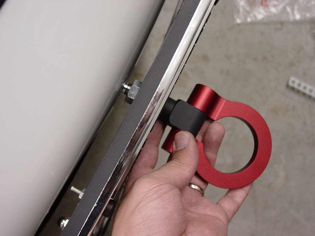

put the tow hook on the use a screw driver to tighten the nut.
clears the bumper perfect.
