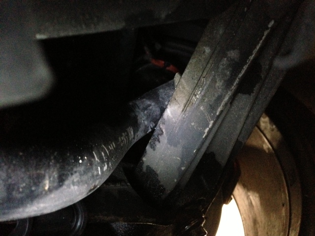

My vehicle is at a shop and they just installed KW V3's on my car which I purchased from another member. The problem is they are having the H&R sway bars rubbing on the lower front control arms.
The shop thinks that it is the drop links. I got off the phone with KW and they informed me that the kit re-uses the stock drop links and they should work without a problem and it should work with my H&R sway bars.
The shop that is installing it said they confirmed that the coilovers are on the right sides.
I am getting a little irritated as this should be a straight forward set up and it seams like I have a mystery situation.
Any incite or help would be greatly appreciated!

I'm assuming the LCAs were properly installed - are you sure the sway bars are for a turbo and not a GT2/GT3?
