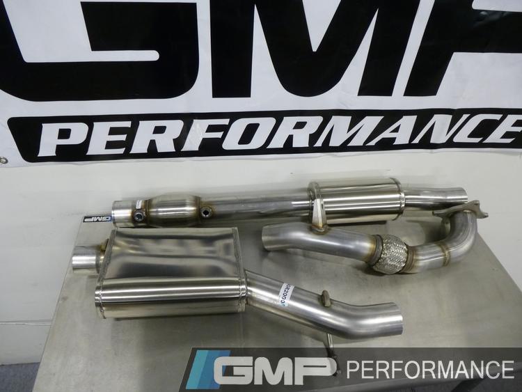

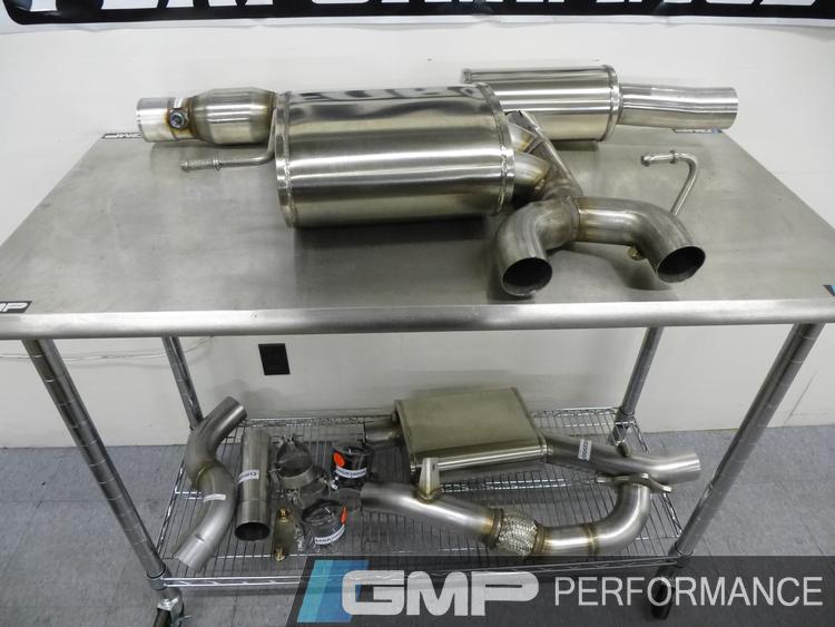

To start things off it was time to let the R breathe and also add that extra little tone to let everyone know that this wasn't just another 4-door Golf. The new system was pulled out of the boxes and made ready for installation.

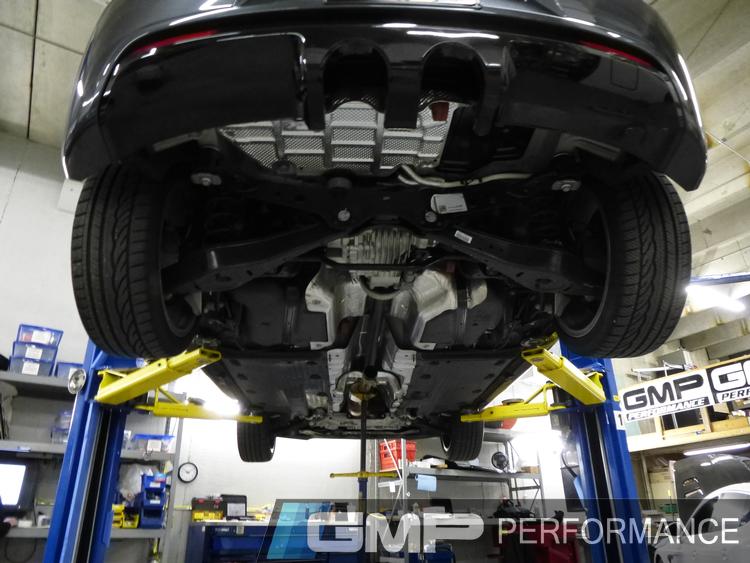

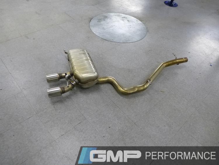

Time to now start removing the old stock parts

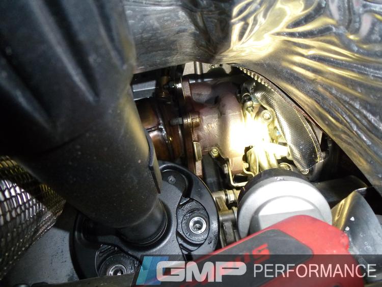

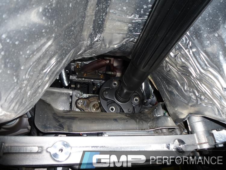

In order to get the stock downpipe out due to the driveshaft placement....
...the driveshaft is unbolted and moved to the side to allow clearance.

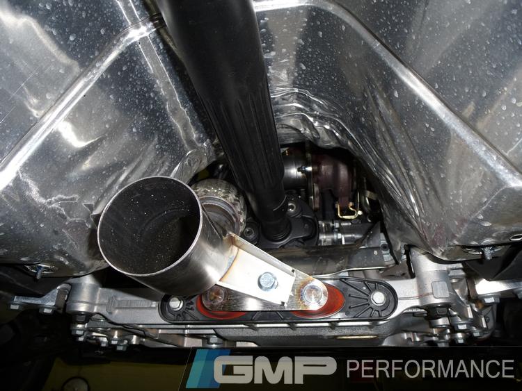

Now the new downpipe in place

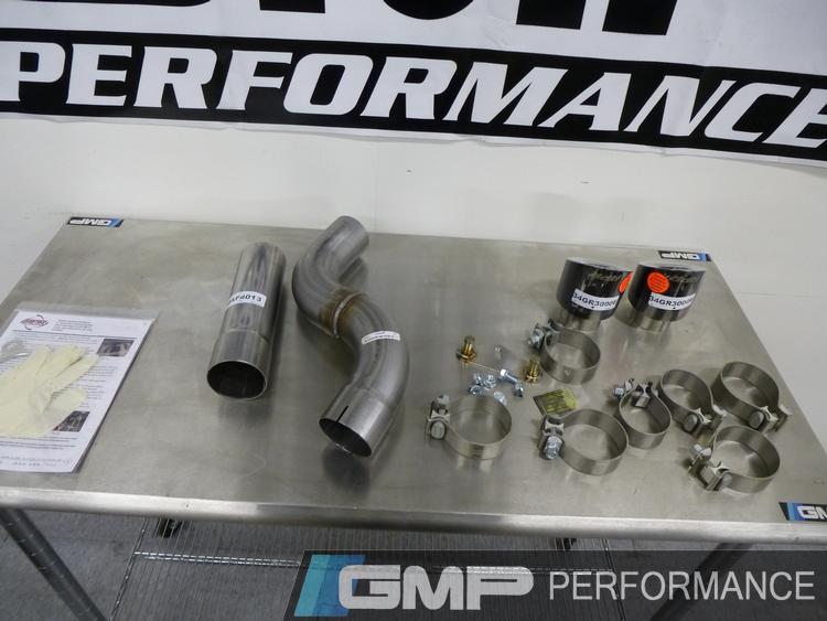

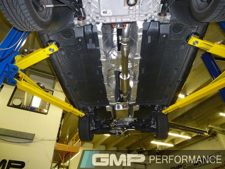

After the downpipe all the other pipes were put into place loosely to allow for proper adjustment

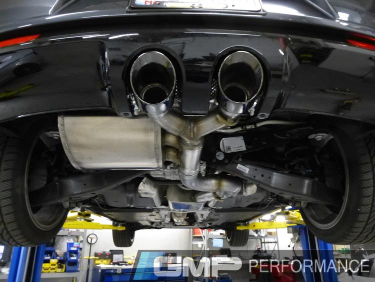

With the muffler and tips installed and everything adjusted into place the system was gone over one last time and all bolts torqued down tight.

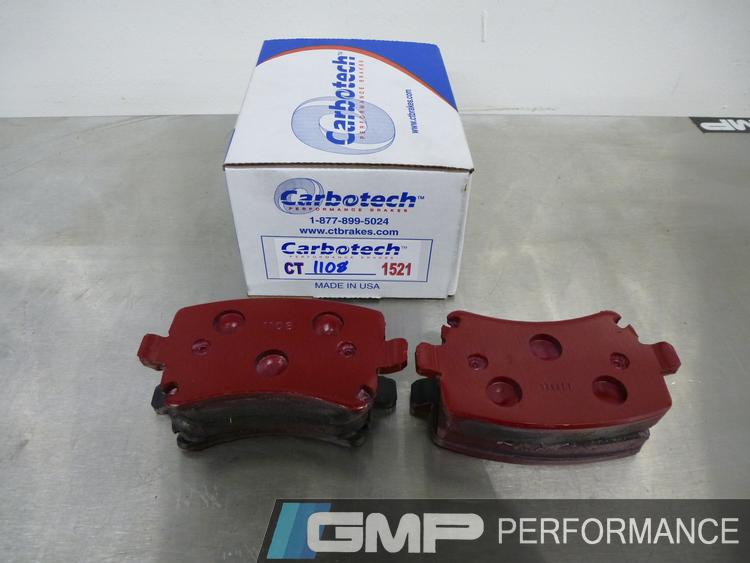

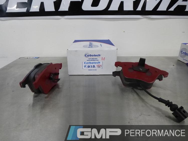

After all the extra gains in power our customer wanted to go ahead and upgrade the brakes to a set of our Carbotech brake pads.
