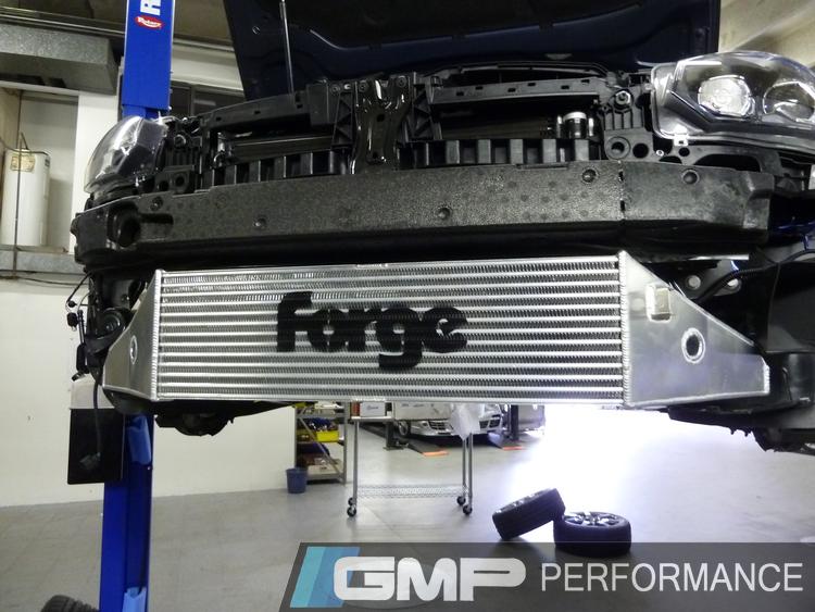

Intercooler
Forge Motorsport worked hard to create their front mount intercooler for the Golf R. They wanted to make sure it provided the greatest possible cooling efficiency with the least negative side effects and least modification to the vehicle for installation. It looks great when it's all installed too!
Before
Installed
And after
Attach all the hoses and its done. This customer chose black but Forge lets you choose between black, blue and red, to give that little extra customization which we think is pretty cool of them.

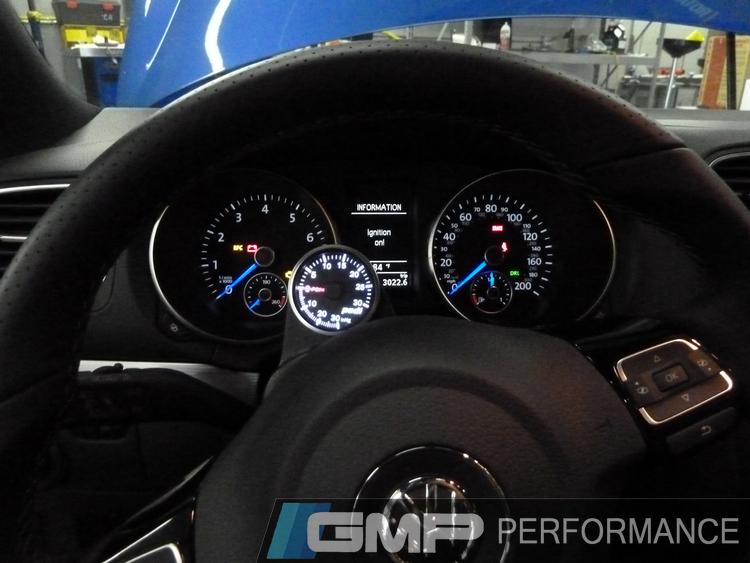

The Podi gauge

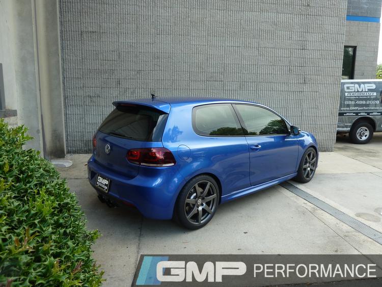

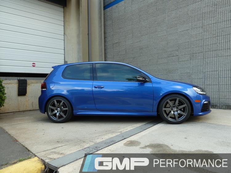

Neuspeed RSE07 Wheels and Michelin Super Sports
Looks? Check. Performance? Check. Happy customer? Check. And with those all met, this baby was out the door, equipped with just a bit better of everything.
