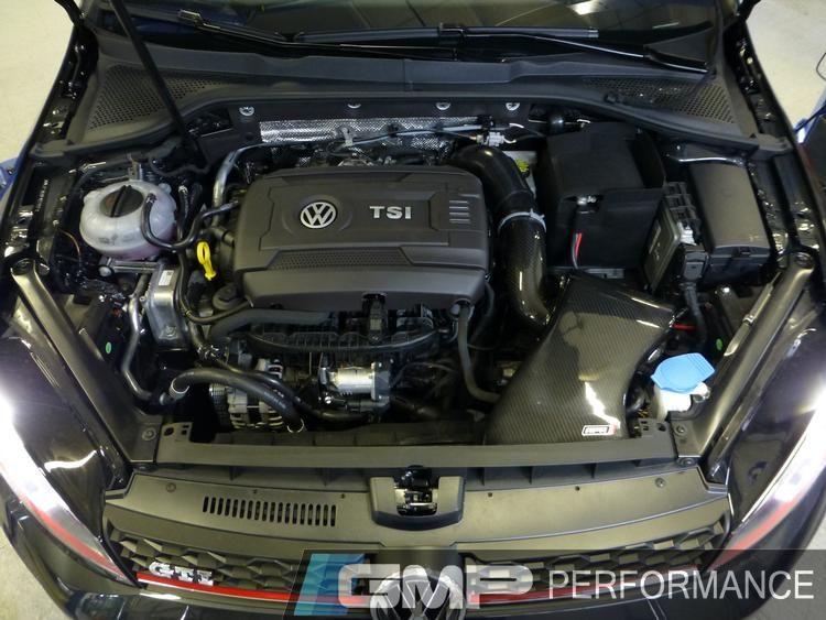

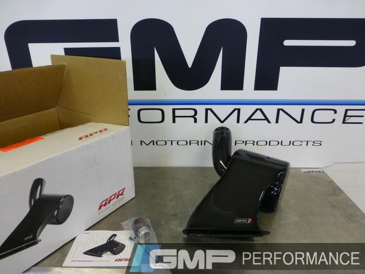

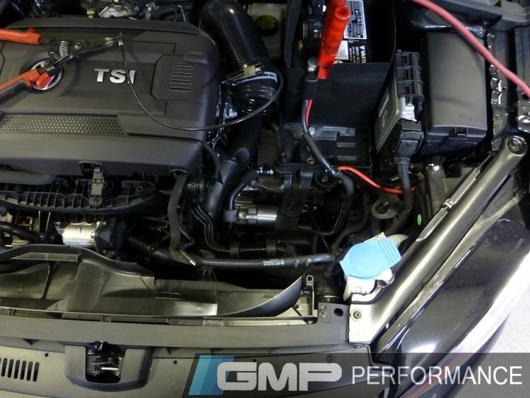

Installed a CAI on a MK7, thought we would show a few install pics. Enjoy.

The APR Carbon Fiber Intake System is an attractive high performance upgrade for the latest 1.8T and 2.0T engines as found in various MQB platform vehicles.

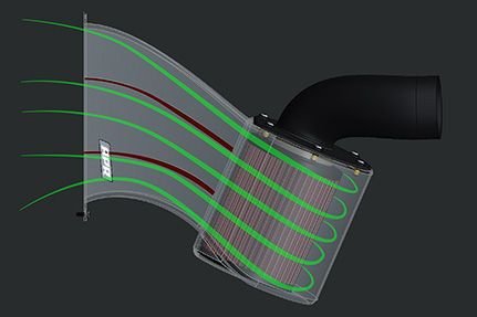

Volute Filter Chamber
Through CFD optimization and flow-bench validation, the intake’s filter housing was shaped into a reducing spiral, or volute, which uses the inertia of the air entering the system to increase pressure on the outside of the filter. This creates an even pressure distribution across the entire face of the filter, rather than only a few key spots, and as such, maximizes utilization of the filtration element.
Compared to many other popular intake styles, the APR intake system allows for the use of a small, compact filter with better filter utilization as systems often twice its size.

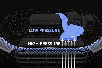

High Pressure Inlet Snorkel and Sealed Design
Unlike traditional open element filters, the APR intake design only pulls air from the leading edge of the vehicle’s hood. In doing so, it draws air from an area of relatively high pressure. As the vehicle increases in speed, pressure continues to build and ultimately aids in the intake’s effectiveness.
By sealing the intake system, pressure created during the ram air effect and volute design is not simply lost within the engine bay. This is contrary to open element filters that pull air from a relatively low pressure region formed within the engine bay.

Directional Turning Vanes
As air enters the intake entrance, directional vanes ensure airflow is properly directed towards the entire length of the intake filter rather than only a small portion. This results in a reduction of air turbulence and creates an event pressure distribution over the entire filter surface for maximum filter efficiency. As the filter becomes dirty with age, performance drop happens less dramatically as particles form evenly over a larger portion of the intake rather than localizing to one location or another.

In an effort to maintain the lowest possible starting IAT, the APR Intake system begins by drawing air from the coldest possible location, which is the front end of the vehicle before the radiator. Air travels a short path through the intake system, past the filter and on its way to the turbocharger through a sealed intake design that prevents ingestion of hot, under-hood. Finally, the intake’s carbon composite design features a thin fiberglass backing, which improves thermal insulative properties.

Upon opening the hood, it’s clear to see why the APR Carbon Fiber Intake System is so highly sought after. Featuring a carbon fiber 2x2 weave common to the engine bays of Audi’s high end of Quattro GMBH vehicles, the intake demands attention and delivers form that matches the intake’s function despite playing a secondary roll in the design requirements.

The intake system comes preassembled from APR ready to be installed in minutes with minimal tools. With the factory unit removed, the intake slips into place and connects to the factory turbo inlet pipe using the OEM hardware without filling the engine bay with additional couplers and hose clamps. Because the system fits in the OEM location, it’s fully compatible with future upgrades from APR, including our larger Stage III Turbocharger Systems.
