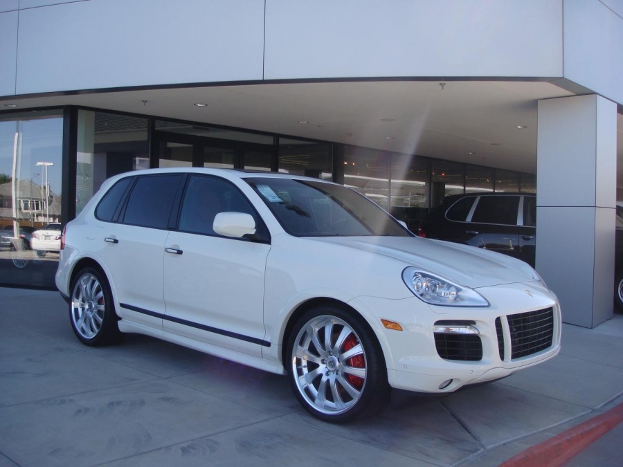

I'm interested in buying my first set of new/replacement wheels and tires for my Cayenne, but have no idea what to look when doing so.
- I assume I should beware of the seemingly great deals on eBay, but to what extent?
- When switching to a new set of wheels/tires (I'm only interested in buying them together) can I put them on myself or do they need to be done by a service technician?
- Will my TPMS still work with a new set of rims?
I really like this this set of rims. Do you think its a legitimate deal?
What do you think about this this set?
Any other information you can offer from personal experience would be appreciated.
