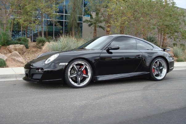

If your car is the one in your avtar it appears to be an 02>+ C2...if so you can run a 19x8.5 front using an ET+40-50MM using a 235/35-19 tire, and for the rear you have 2 options...you can run a 19x10.0 with a ET40 using a 275/30-19 tire, or you can run a 19x11.0 with a ET+52 and use a 315/25-19 tire.
We have a few 5 spoke design wheels that we offer...attached is an example of a 997 with a set of our NUTEK 501 wheels, the finish was a full brushed finish on the center and outer, and black ceramic on the spoke face and black ceramic pinstripe.
