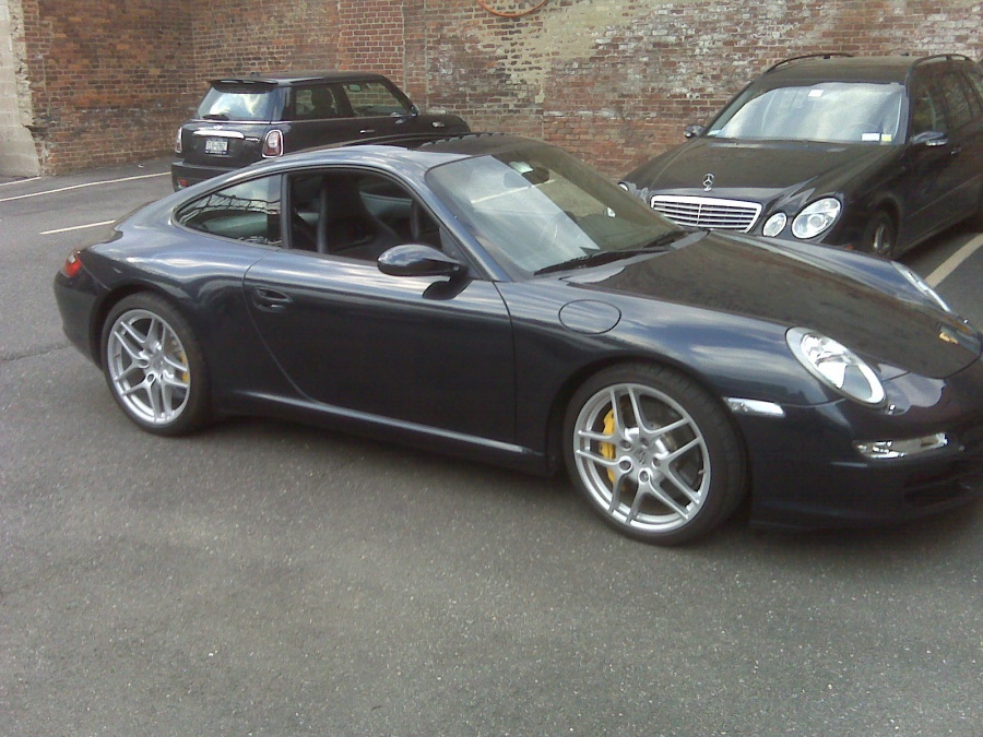

C4S on C2S - it works.
It's been done and discussed on this and other forums. Here's what it looks like on my C2S. It does not stick out. This is a factory widebody offset. What you can't do is buy the aftermarket (non-OEM) aggressive offsets for the widebody and try to put them on the narrowbody. In that case, it may stick out (varies on rim width and offset).

Thanks NYC, yours is 997.1 right? Will it work on 997.2 cars?
Old May 4, 2010 | 08:08 PM
NYC_Z06's Avatar
Joined: Jun 2009
Posts: 382
From: Dallas
Rep Power: 35
NYC_Z06 is just really niceNYC_Z06 is just really niceNYC_Z06 is just really niceNYC_Z06 is just really nice
Correct, I have a NB 997.1. It will work on the 997.2 NB. There's no difference. Front offset is same. Rear is ET 51 for widebody; ET 67 for narrow.
