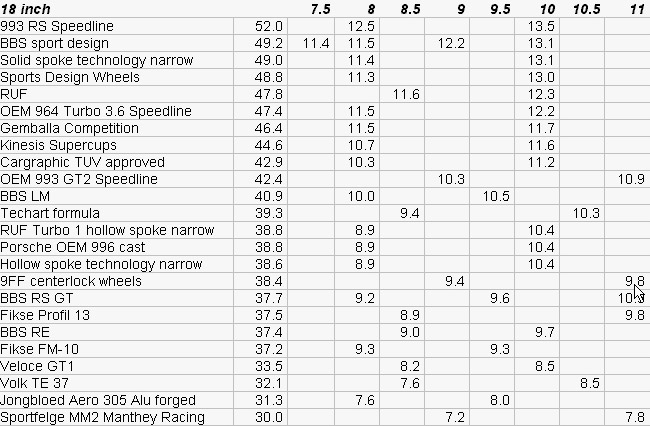

Want to know what your wheels weigh?
Weight is in kgs and for 18". You can also see the difference in width.

So it's time for 9FF or Manthey wheels?
Here's more from various brands, www.wheelweights.net

I thought TechArt Formulas were a lot heavier than 22 pounds (10kg). Are these numbers accurate?

Originally Posted by prubin
I thought TechArt Formulas were a lot heavier than 18 pounds (39.3kg). Are these numbers accurate?
Are you being accurate
The list says these weights for Techart Formulas:
a 8.5x18" is 9.4 kg (20.68 lbs) and a 10.5x18" is 10.3 kg (22.66 lbs)

Whoops! Sorry about the error. In any case, I thought that Techarts were closer to 29 lbs.....

I can verify that the Volk TE37 weights are correct. Weighed mine before mounting the tires.
