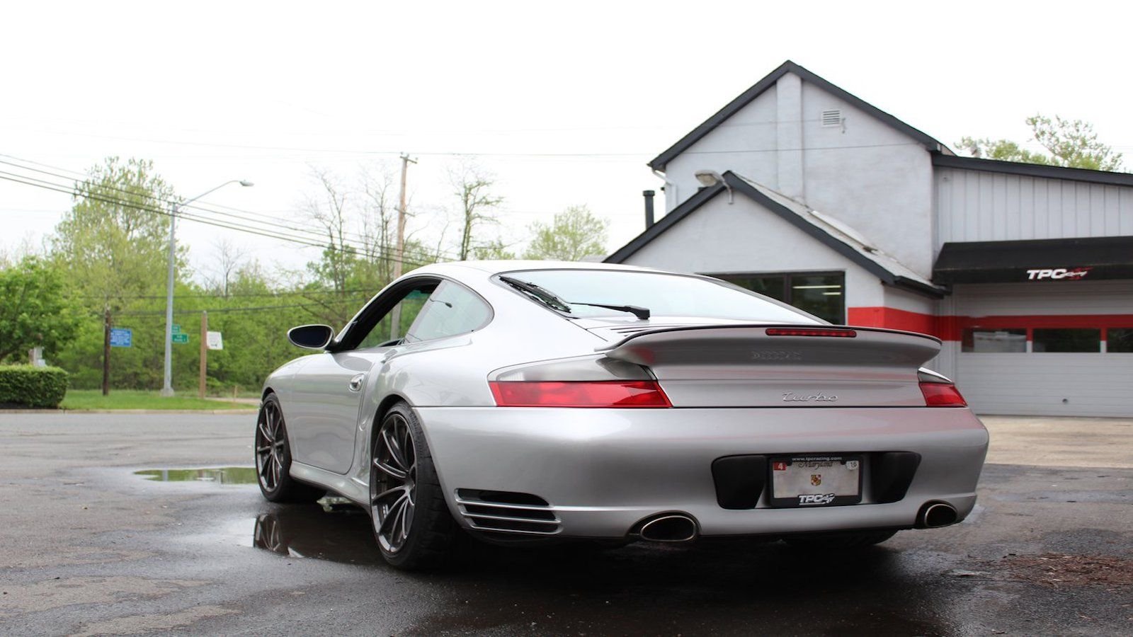

Unassuming ride
The Porsche 996 Turbo is a rather simple looking Porsche. It's the first '911' that replaced the long standing air-cooled motors with a water cooled engine. The entire body has been revamped to look more sleek. The interior itself underwent a number of changes as well.

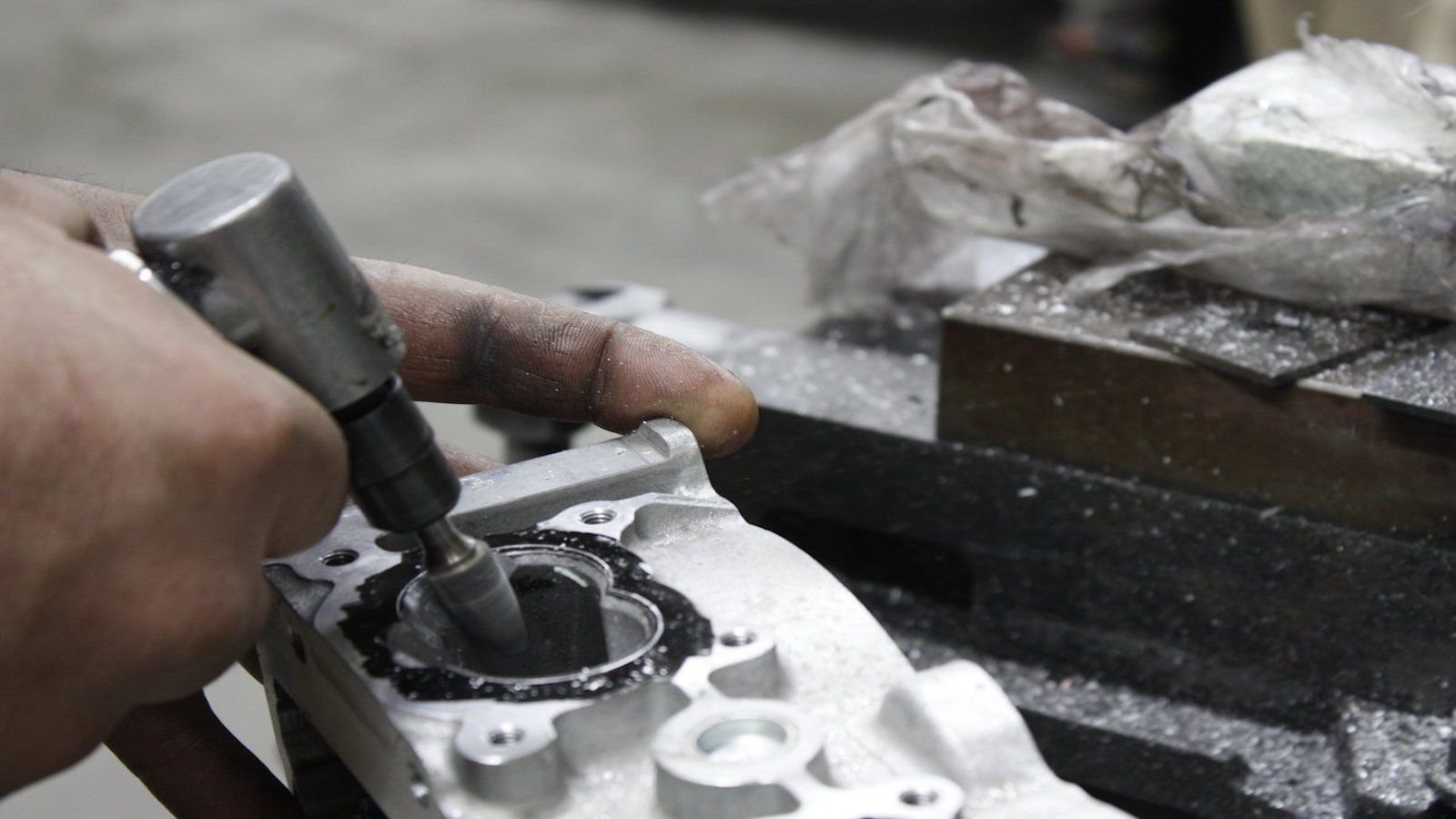

Marco, Port-O!
Anybody can slap a turbo on a car and claim huge increases in horsepower. But there is an actual science to how a combustion motor works in harmony with other components to produce consistent, linear power at the crank. This Porsche underwent serious tuning from the motor to the crank. The upgrades also included porting the heads, which allows more air to enter the engine. TPC employs a wizard lead tech, Marco, who has served as a tech in the British Supercup and was responsible for porting the head on this engine to proprietary specs.

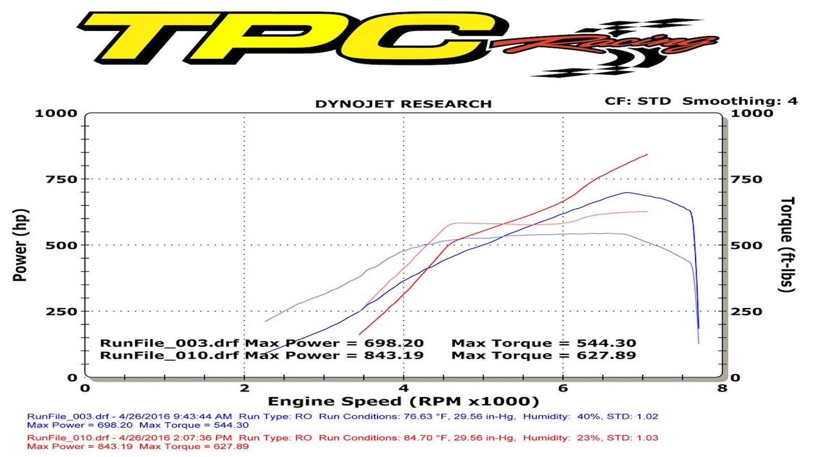

The results are in!
The company posted their Dyno results from the upgrades, and they came damn close. The engineer felt that the rear tires would produce some wheel spin on the dyno and that could prove catastrophic. As the motor was freshly built, they wanted to be keen to produce the results without risking failure. Once all the parts are broken in, there's no doubt the car will scorch the 1,000hp mark. Through this dyno, they were able to put down 843 wheel horsepower and estimate the crank hp to be 991hp. That's just 9hp short of the original goal. The customer will likely bring the car back for a re-tune and hit the milestone originally intended.
