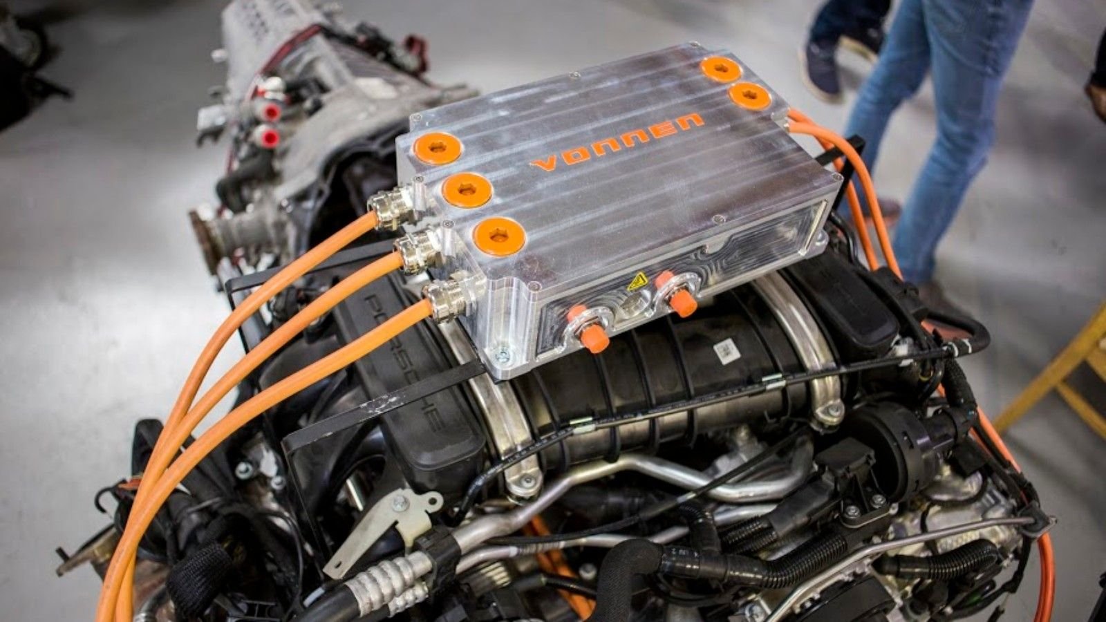

The conversion process begins with a stock Porsche.  Vonnen bolts its liquid-cooled Motor Generator Unit (MGU) to the crankshaft in place of the stock flywheel.  An inverter gets mounted to the top of the engine, which takes the DC current generated by engine braking and converts it to AC power to feed to the battery pack mounted in the front trunk.  The electric motor adds an additional 150 hp and 150 lb-ft of torque over stock, with only a 170-pound net weight change (approximately, including weight removed). The system is designed to fit either automatic or manual transmissions.

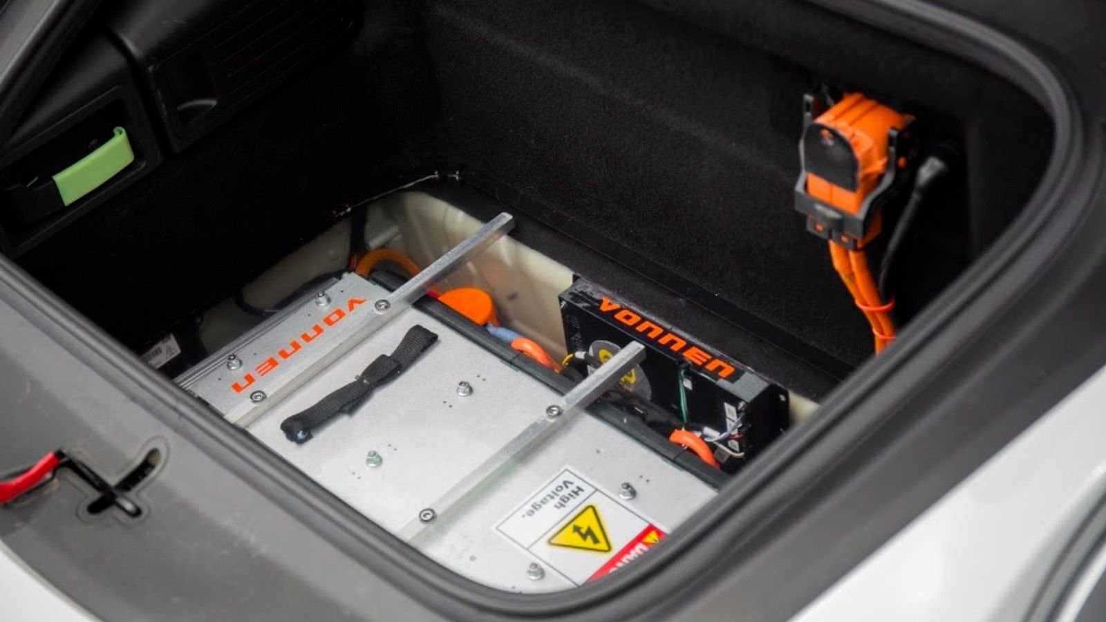

The 400-amp liquid-cooled, lithium-based, Battery Management System is specifically designed for rapid charge and discharge rates.  Storing power from the regenerative braking system, the smaller and lighter hybrid battery replaces the starter motor to power the engine and the vehicles other accessories.

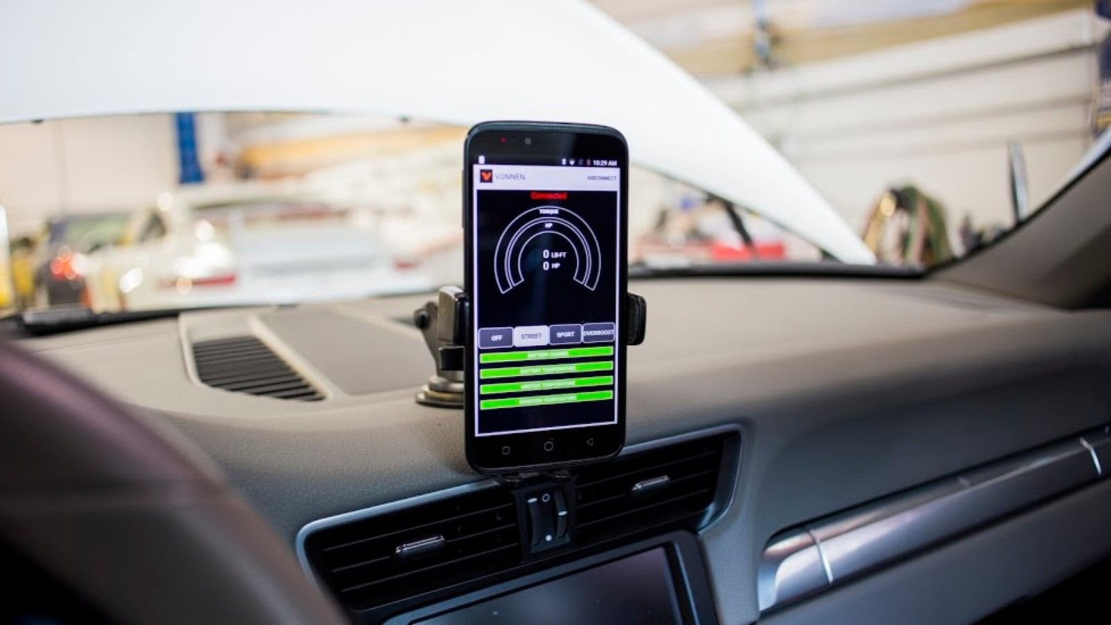

App-based Control
Of course, because it's 2019, there's an app to access this system.  Via Bluetooth, the app provides real-time system monitoring, social sharing, driving mode selection, and an on/off toggle to enable/disable Shadow Drive entirely.  Speaking of driving modes, there's three: street, sport, and overboost.  From a mild bump to 100% of VSD’s power and torque for a few seconds of all-out boost, the system will automatically power down, recapturing energy from the engine and regenerative braking, which allows everything to cool.  The end result of VSD is a seamless wave of torque from 0 rpm through redline, greatly augmenting the “area under the curve” of the stock engine’s torque band, without altering emissions.
