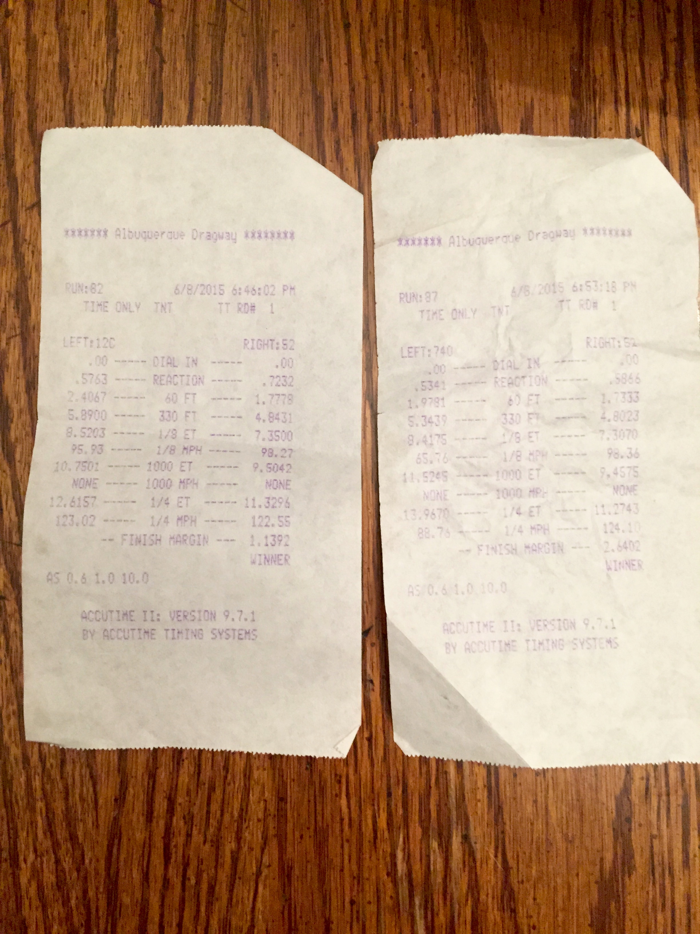

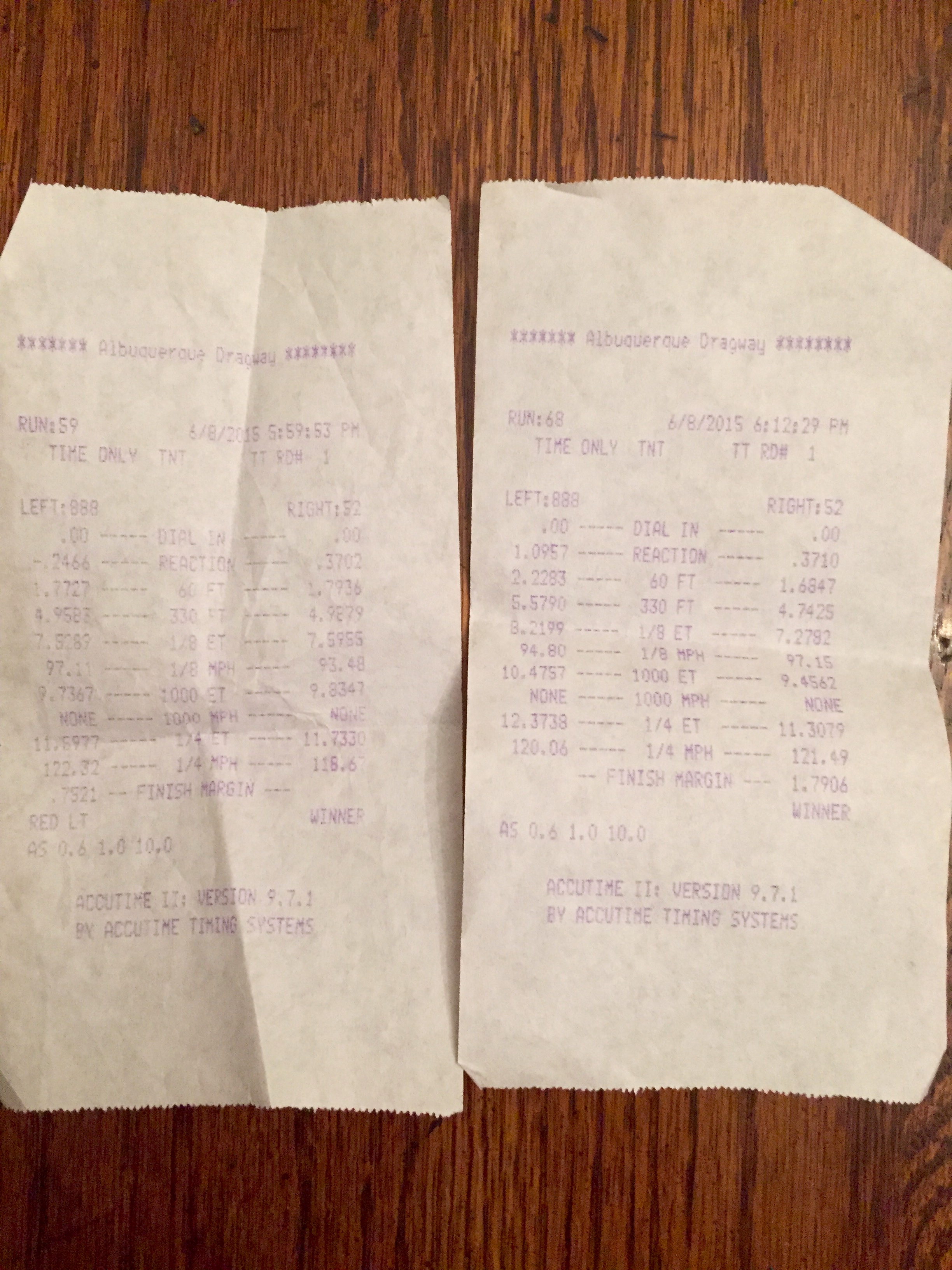

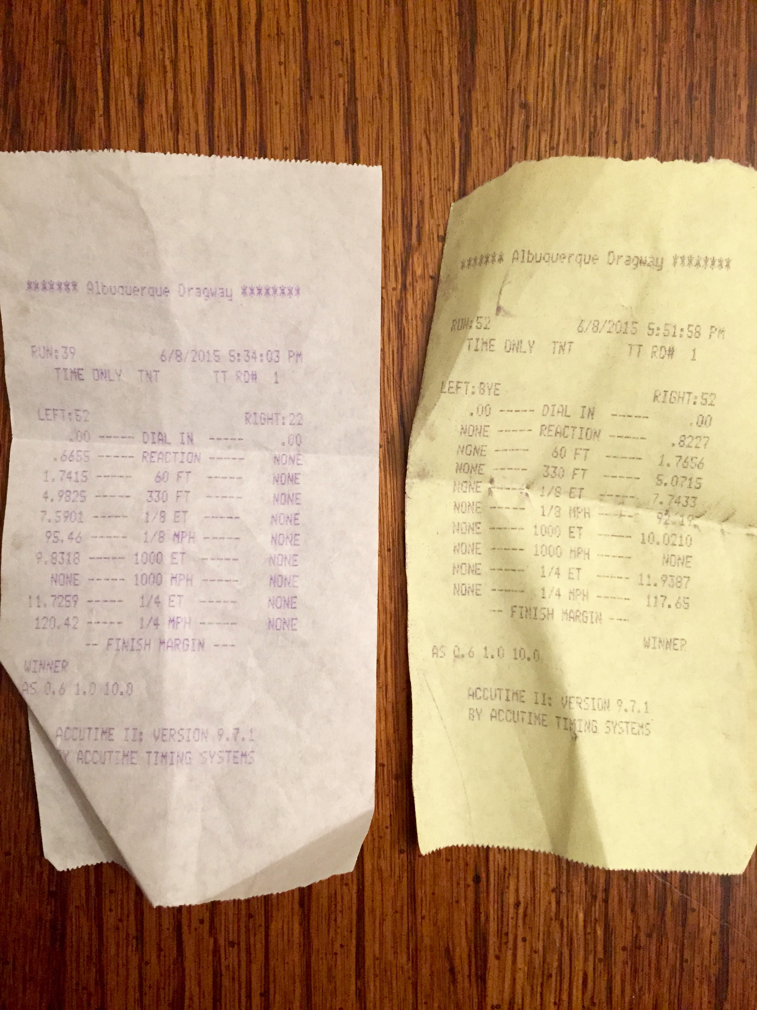

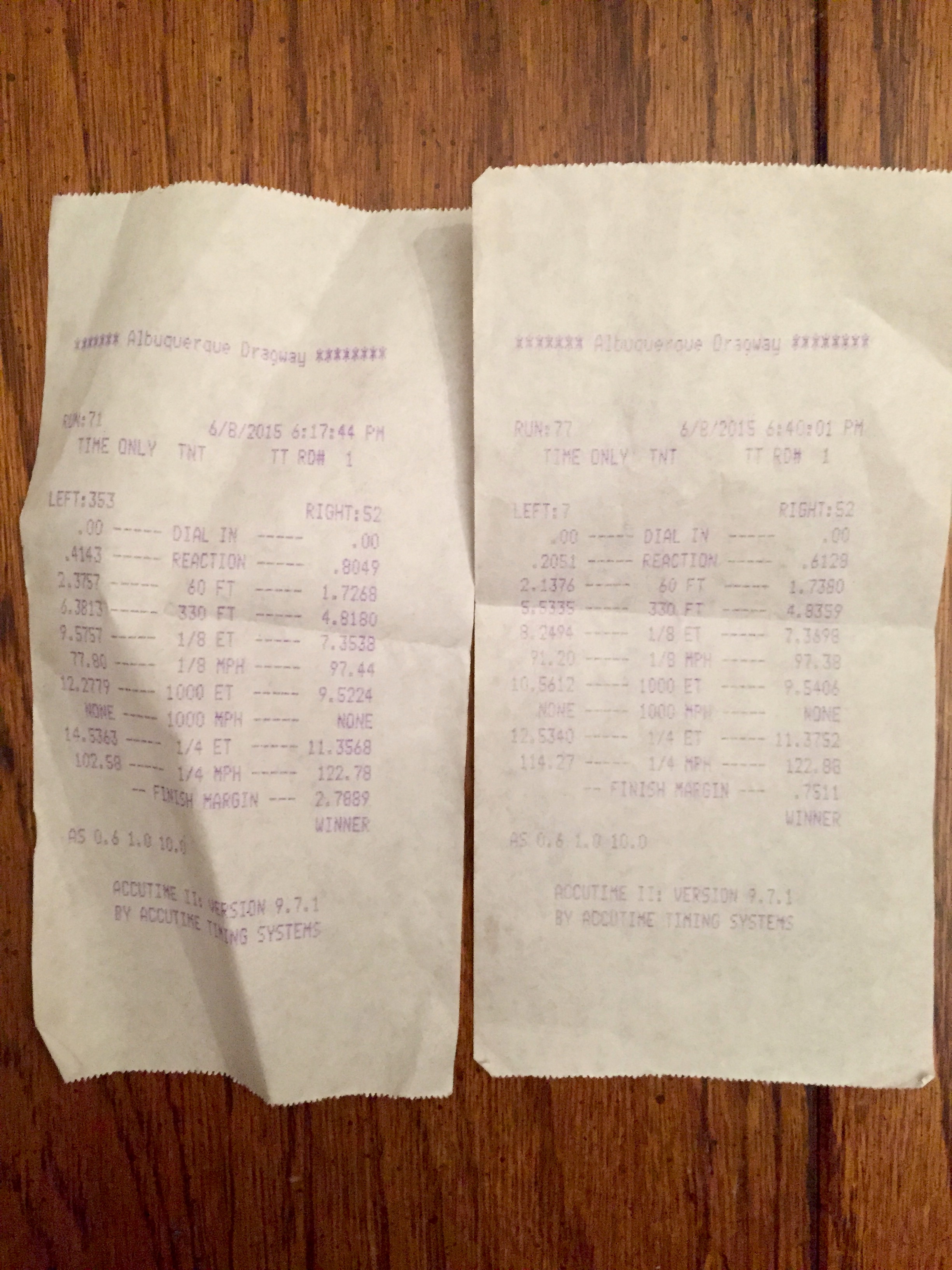

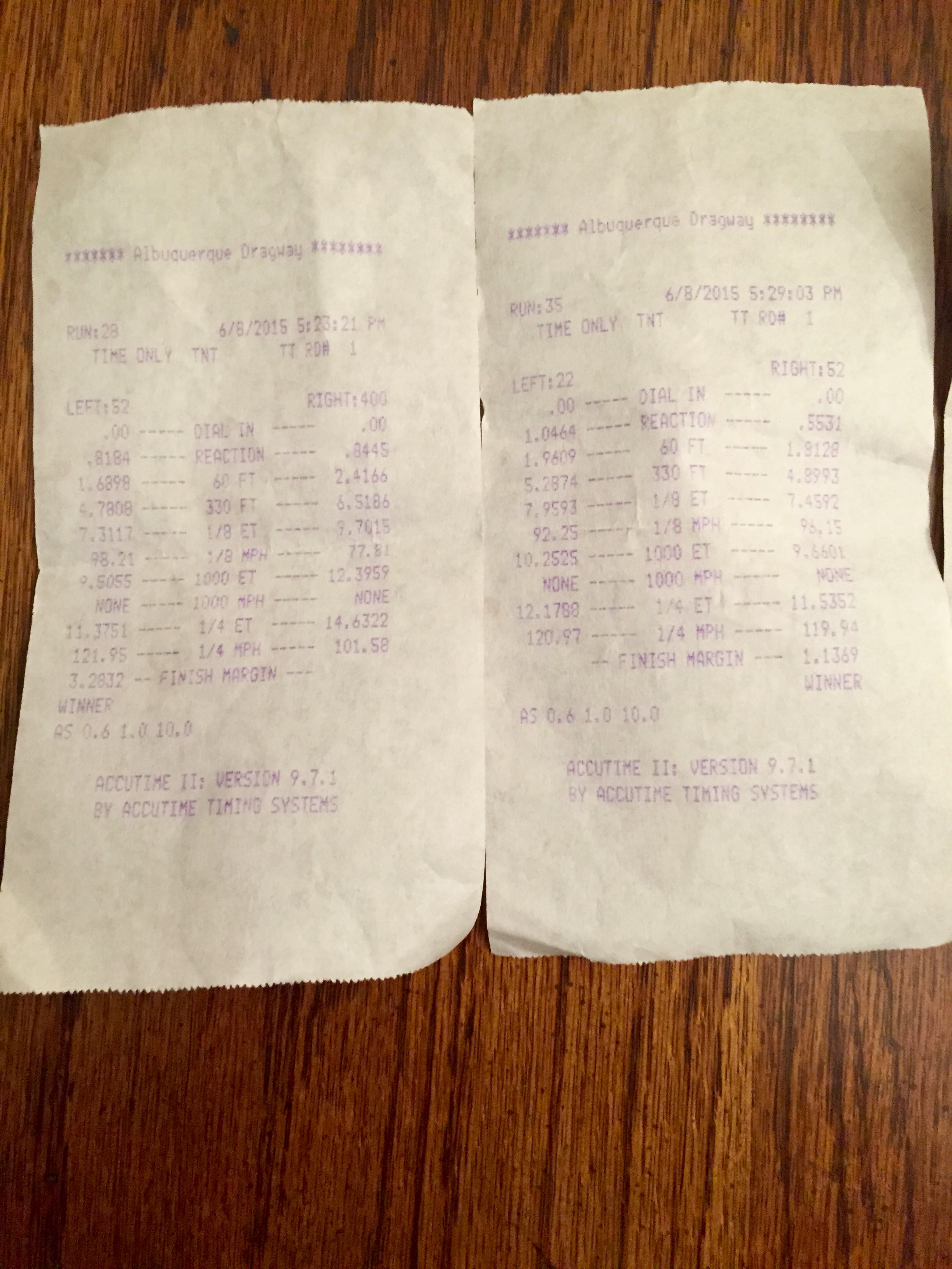

This is a follow up post to my thread with the Youtube videos of several of my runs on June 8, 2015 at Albuquerque Dragway during goldRush Rally 7: https://www.6speedonline.com/forums/...dragstrip.html.
In this post, I analyze, based on the time slips, the effects of heat soak power loss and then the addition of top shelf race gas (Torco 108 -- the Torco equivalent of VP's MS109) paired with the GIAC Stage 2 race gas tune subfile.
Here are the pictures of my time slips. My best run was, of course, on race gas with the GIAC Stage 2 race gas tune file activated. It was an ET of 11.2743 with a trap speed of 124.10. According to the dragtimes.com density attitude correction calculator, the DA at the time of this run (6:53 pm local time) was 7,721 feet (the track elevation is 4943 feet and at the time of this run the air temp was 82 degrees F, the barometric pressure was 29.87 inches and relative humidity was 31%).
Running that through the correction calculator yields at sea level ET and trap speed of 10.796 at 129.377 mph. See http://www.dragtimes.com/da-density-...ect+ET+and+MPH
The result would have been a lot faster if the car were cool and running race gas.
These time slips show the brutal effect of heat soak on the performance. I am car number 52 in the slips. The car's performance mods: GIAC Stage 2, Europipe exhaust with 100 cell cats, IPD Plenum, BMC filter and Champion Race Diverter Valves. Tires were Michelin Pilot Super Sports in OEM sizes riding on ADV005 track spec CS wheels with titanium fasteners in OEM sizes (ADV1's top of the line and lightest wheel with a retail price of about $15,000). Car has no suspension mods.
All runs were using launch control with spoilers retracted and the PDCC button off to allow for the most weight transfer on launch to the rear wheels. The car was emptied of any luggage or extra weight. The AC was off and everything electrical that could be turned off was turned off. Windows were closed and, to minimize drag, I did not mount GoPros or anything else on the outside of the car.
The first five runs were on pump gas.
The first run, when the car was cool, was a 11.3751 seconds at 121.95 mph.
In the second run, the numbers worsened to 11.5352 seconds at 119.94 seconds.
In the third run, the numbers worsened more to 11.7259 seconds at 11.7259 seconds at 120.42 mph.
The fourth run was the worst of the day: 11.9387 seconds at 117.65 mph. This is just massive soak power loss -- an ET .5636 seconds higher and 4.3 mph slower than the first run -- both on pump gas.
The fifth run wasn't much better: 11.7330 seconds at 118.67 mph.
Then I added the Torco 108 race gas, switched to the race tune file and things got much faster.
The 6th run (1st on race gas): 11.3079 seconds at 121.49 mph -- a run even better than when the car was cold on pump gas. This run also had my best 60 foot time of the event -- 1.6847 seconds.
The 7th run (2nd on race gas): 11.3568 seconds at 122.78 mph.
The 8th run (3rd on race gas): 11.3752 seconds at 122.88 mph.
The 9th run (4th on race gas): 11.3296 seconds at 122.55 mph.
The 10th run (5th on race gas) was my fastest: 11.2743 seconds at 124.10 mph.
What this showed me is that the race gas essentially restored the power than I lost to heat soak. Unfortunately, I never got to run the car on race gas when it was cool. Had I been able to do so (the race gas only got delivered to the dragstrip halfway through the event) the car would certainly have broken into the 10s.
