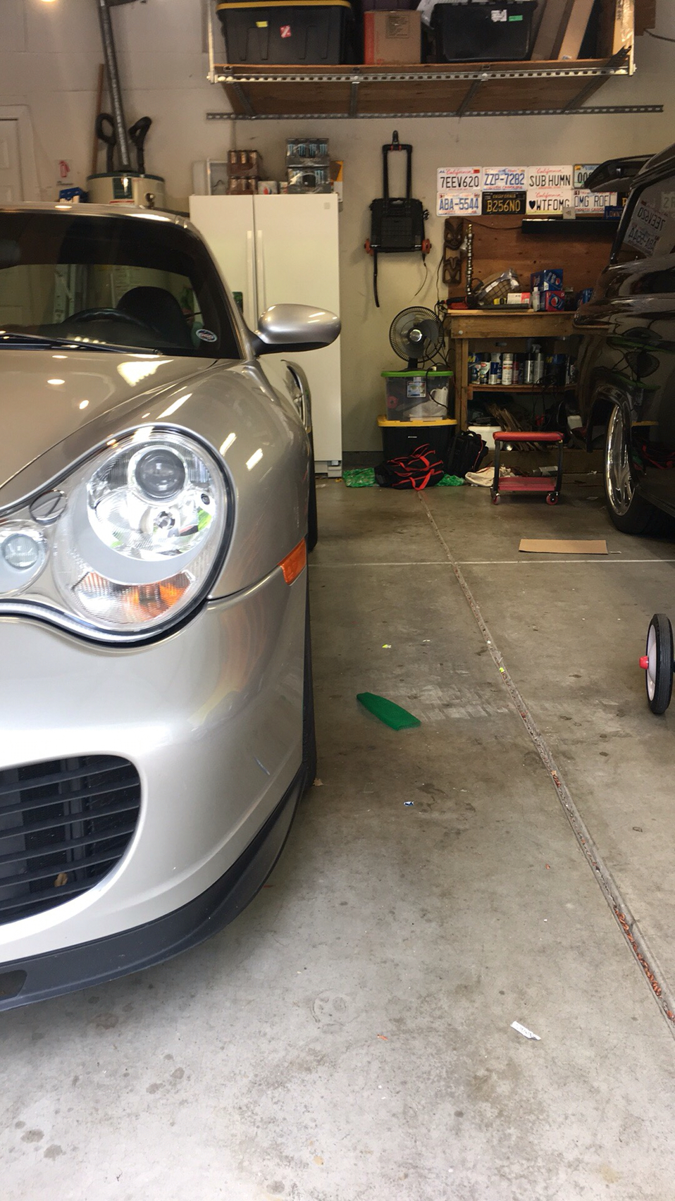

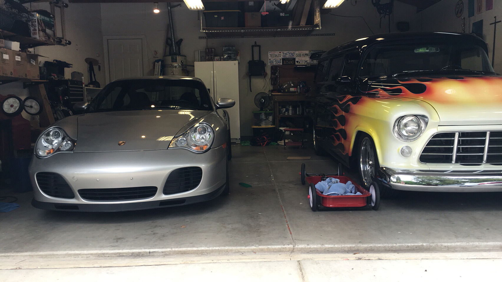

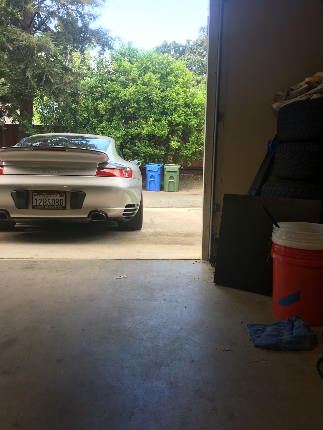

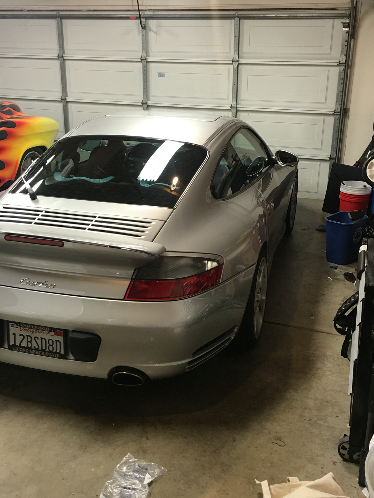

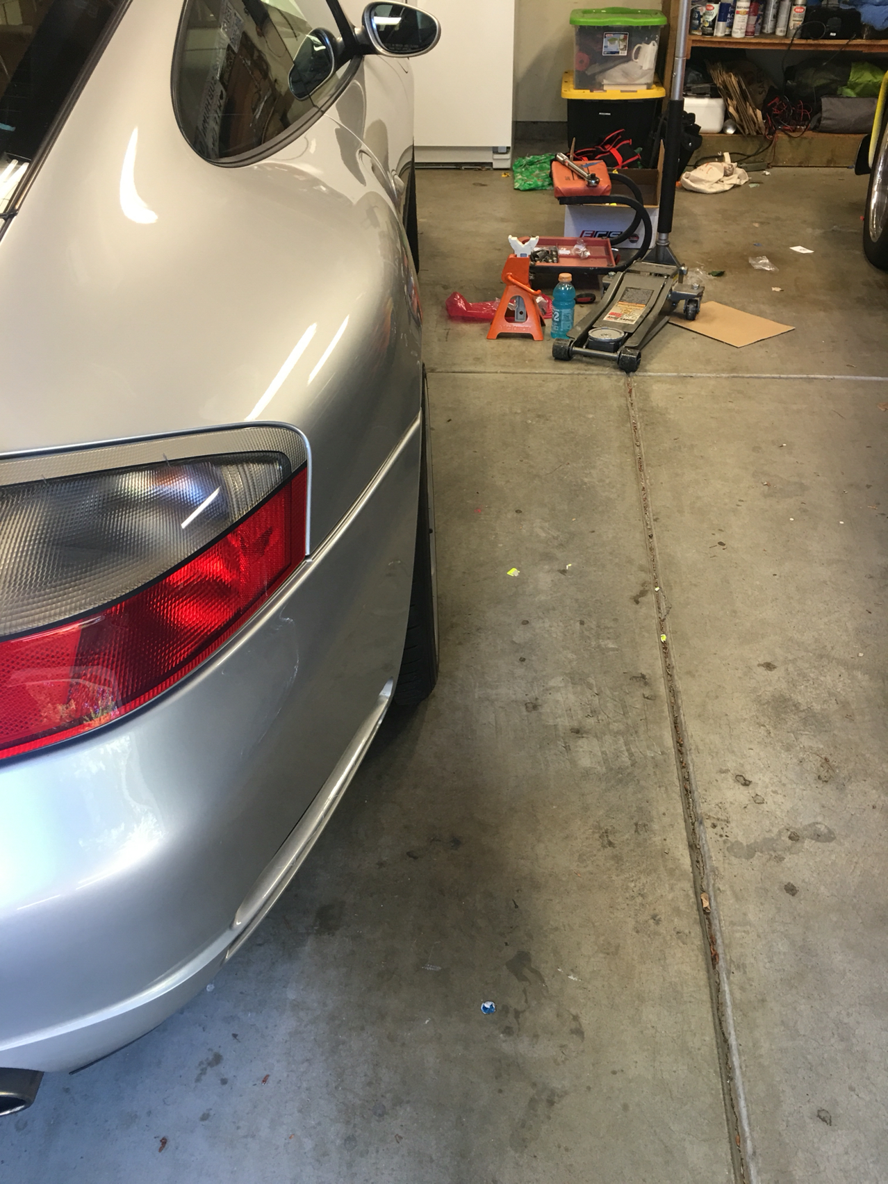

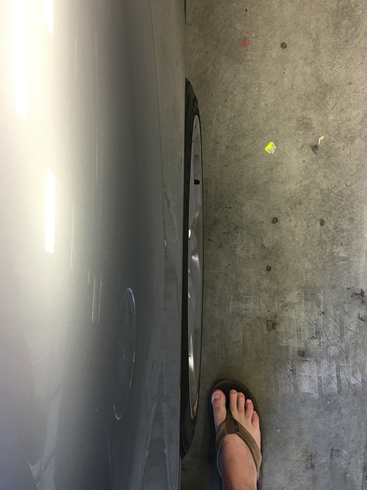

You shouldn't need to roll with only 10mm in the rear.
Here's 18mm
