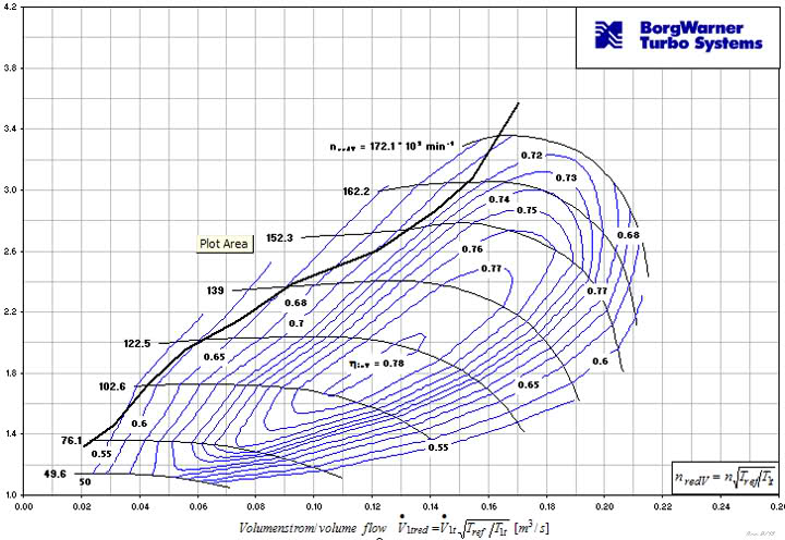

Below 997.1 turbo's compressor chart, flow in m^3/s:
