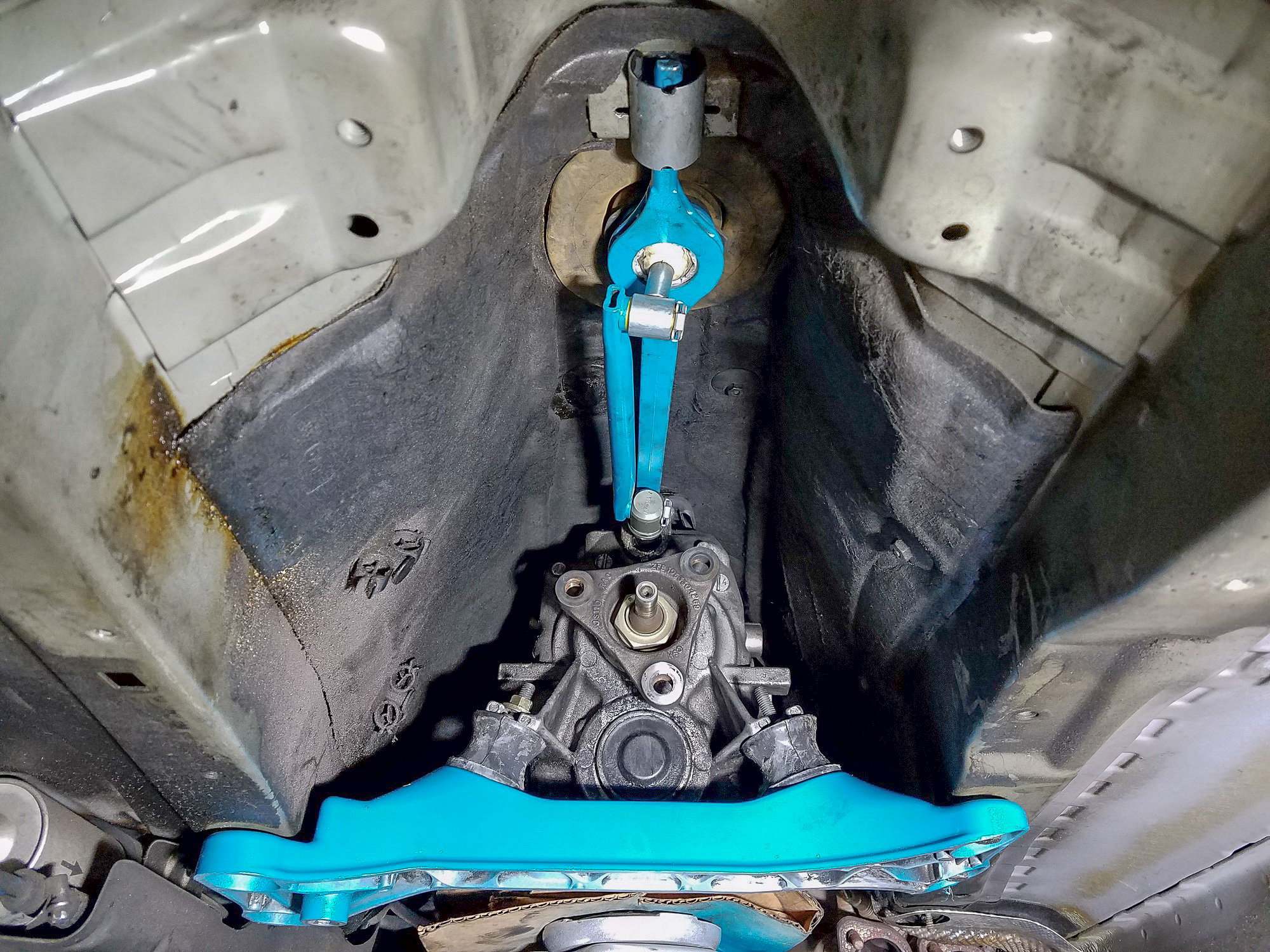

With the full shift assembly out, I was able to knock out all of the old bushings. They were all trashed. However, before I reassembled everything with those shiny, new ECS Tuning parts, I brought out the pressure washer, some sand paper and some rattle cans.
Ferrari has Rosso Corsa, Lotus, and Aston Martin have British Racing Green, my garage has Satin Lagoon. Somewhere along the way, this vibrant blue tone has become synonymous with everything happening in the garage. So, I decided that every bit of Project E46 that I upgrade will get marked in Satin Lagoon to prove its provenance. Thus, the transmission crossmember and shift assembly got a coat of the stuff while I had it all apart.

After everything was cleaned, painted and fitted with replacement bushings, it was time for reassembly. It’s the reverse of the removal process, duh! All jokes aside, as if by magic, putting it all together went smoothly and took about an hour. For those wondering, putting the bitch clip back on is much easier than removing it. Woo-hoo!
