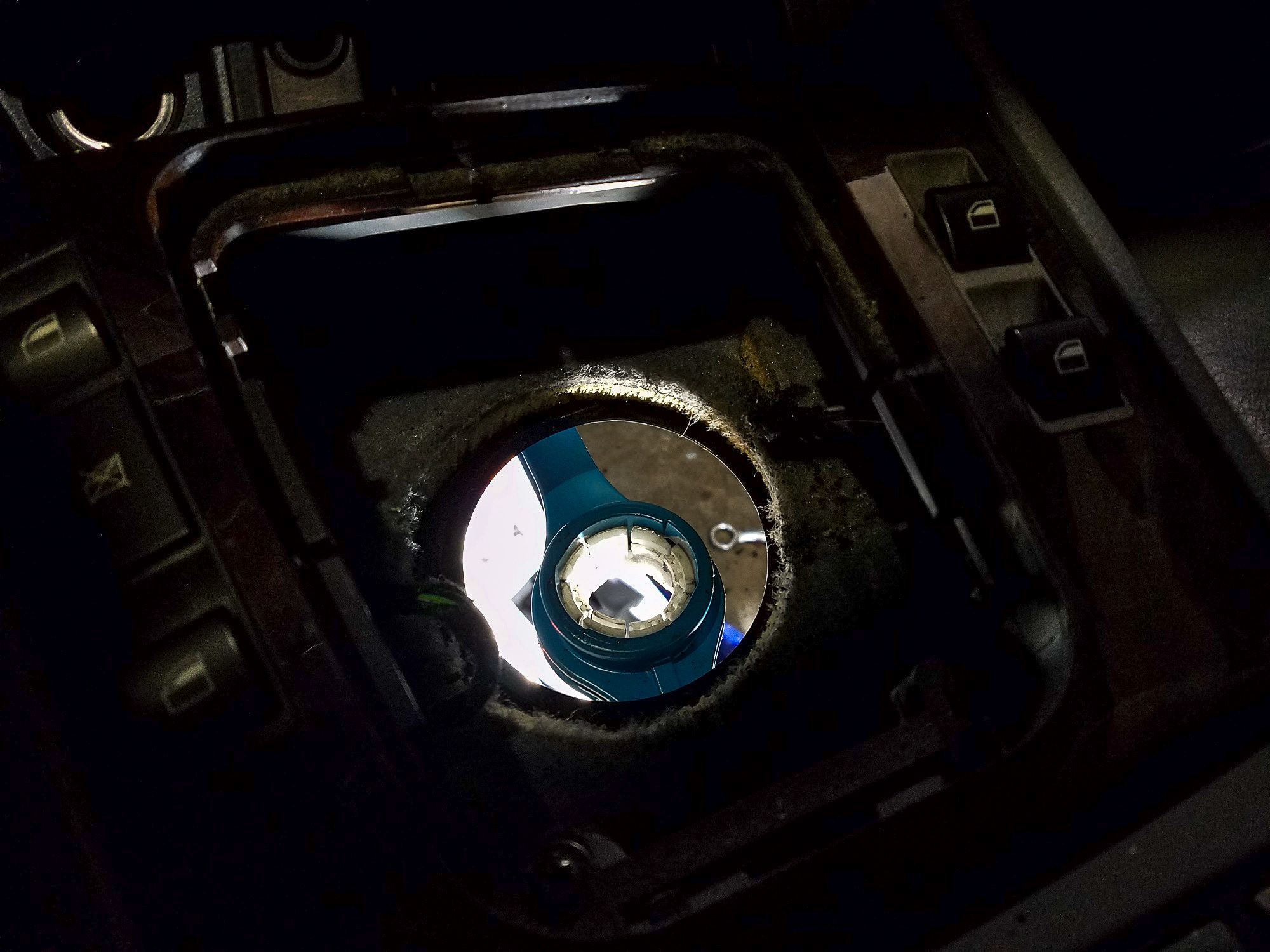

With the shift knob, leather-like boot and foam insulator removed, the shifter itself is now visible. It sits in a white plastic cup. To remove it, twist the shifter counter-clockwise until it “clicks” and then gently pull up. The shifter is now free to be removed.
