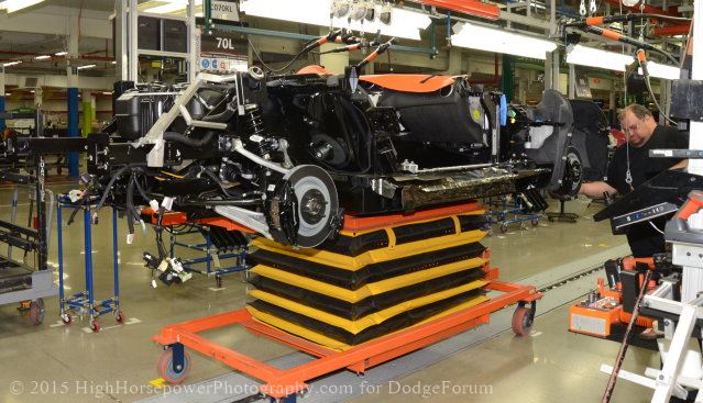

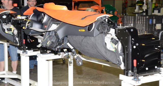

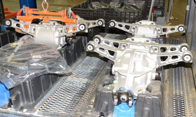

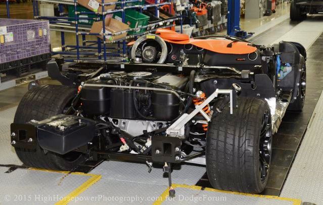

The basic production process of the Dodge Viper begins with a bare chassis and the first items to be added are the dash/instrument panel, the wiring and the rear differential.
DSC_7553

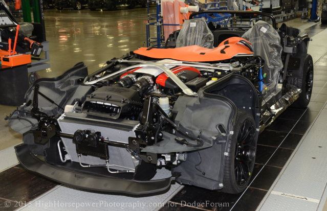

Next, the crew adds the engine and transmission to the Viper, completing the drivetrain before bolting up the entire suspension and steering system, including the high performance Brembo brakes. During this portion of the production process, the Viper also gets the radiator, the fuel tank and all of the fluids.
Before getting the wheels, each Viper is given a proper alignment and after the wheels are fitted up, every single Viper goes into a roller room where the car is driven up to 90 miles per hour – giving the driver a chance to make sure that the transmission shifts correctly, the engine starts, runs and revs as it should, that the steering system works and that the brakes bring the car down from this simulated speed.

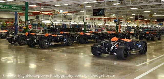

After that, each Viper goes to a staging area to wait for the body and the rest of the interior. At that point, the Viper is like a 645 horsepower go kart and even without the skin – this American supercar looks menacing.

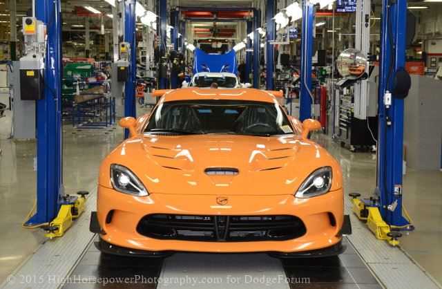

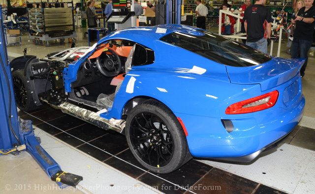

After the Viper has time to cool down from its test run on the rollers, each car hits the second half of the assembly line. The inner portion of the trunk, the rollover safety bar and the race-ready bucket seats are bolted up before the body panels themselves are added – starting with the roof, the rear hatch, the rear quarter panels and the rear fascia. From there, the doors, the hood, the headlights, the side skirts and the front fascia are carefully added to complete the exterior build.

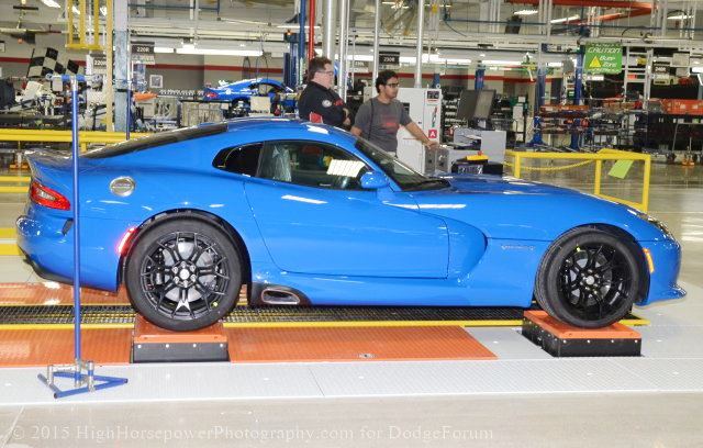

At that point, the Dodge Viper is officially assembled, but each car then goes through a series of tests including a high pressure water chamber test, a suspension test where a series of pistons apply pressure to each wheel individually and a final area where a series of robotic arms measure all of the body panel gaps.

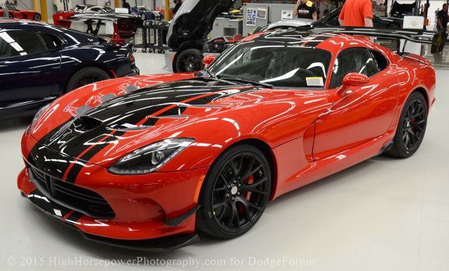

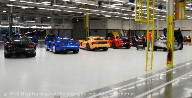

Finally, each new Dodge Viper is visually inspected, cleaned and polished before being shipped to the dealership, with random cars chosen throughout the day and sent to the audit area where every aspect of the vehicle is scrutinized.
