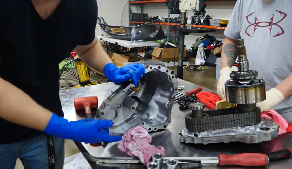

Dahm then steps us through all the parts that he can find that may have been damaged in the explosion. The process starts by pulling off the dash and checking all the electrical components underneath. Some connectors were pulled loose, but nothing seems too bad all things considered. Even the driveshafts themselves faired unexpectedly well. Both shafts are made of carbon fiber and none of the carbon fiber portions failed at all. The front driveshaft was the more impressive of the two. “It hit the metal chassis over and over again. Not once did the carbon fiber let go.” Says Dahm.
RX-7 Transfer Case
The transfer case used in this build is from a Nissan GT-R. It is removed and examined as well to look for damage. Rather surprisingly there does not seem to be anything wrong with it. The unit was purchased used, so that combined with this event is making Dahm decide to take the whole thing apart to do a full health check test on it. Despite all the fireworks all components seemed to hold up fairly well. The clutches were not inspected but they are not suspected of having any issues. “We were doing all-wheel-drive burnouts and the fact that the clutch held so strong is another reason why the car ripped itself in half.” Says Dahm.
