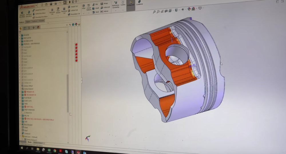

As you might imagine the stock turbo can’t keep up at 1000 HP, so the team is swapping it out for a Borg-Warner EFR 9280 turbocharger. In order for this turbo to work, a new custom turbo manifold is also required. Its crazy how much custom work has gone into this project and we haven’t even gotten to the internals yet. If more details about what it takes to get this engine to that crazy power figure interests you, such as the rods, pistons, and head porting, we suggest you watch the video in full.
