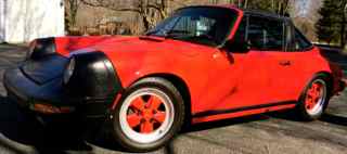

Buy ASAP....Life is too short!
I started with a 2000 911 Carrera Coupe (996) and fell in love with Porsche. 3 months later a bought a 1986 911 Carrera Targa (G series as they call them). I will always have to have a modern Porsche for the modern amenities and daily driver. But I do enjoy driving my '86 and the classic look is addicting, crazy addicting. There are a ton of 996's out there that are great deals in IMO, maintenance is not costly and will run for a long long time. I was pissed off at myself for not buying a Porsche 20 years ago. Both are great just buy one sooner than later and enjoy life that much more!
ID:	384849   Click image for larger version
Name:	86 Pro Pic.jpg
