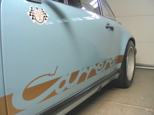

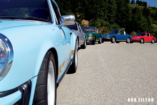

7" and 9" on my '74 carrera (i believe similar size flares as an SC or mid 80's carrera)
