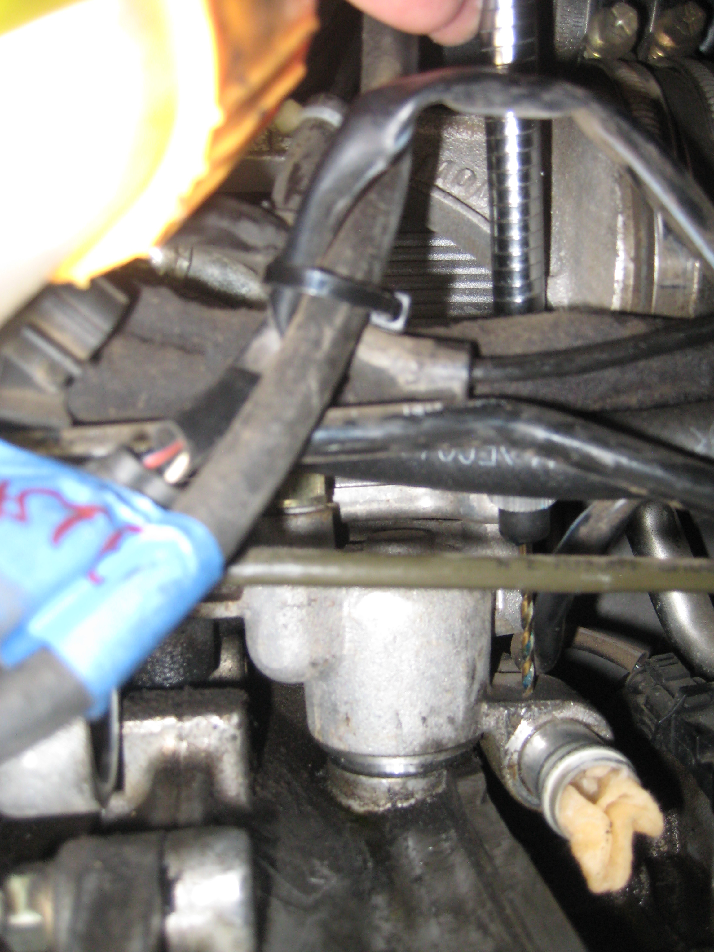

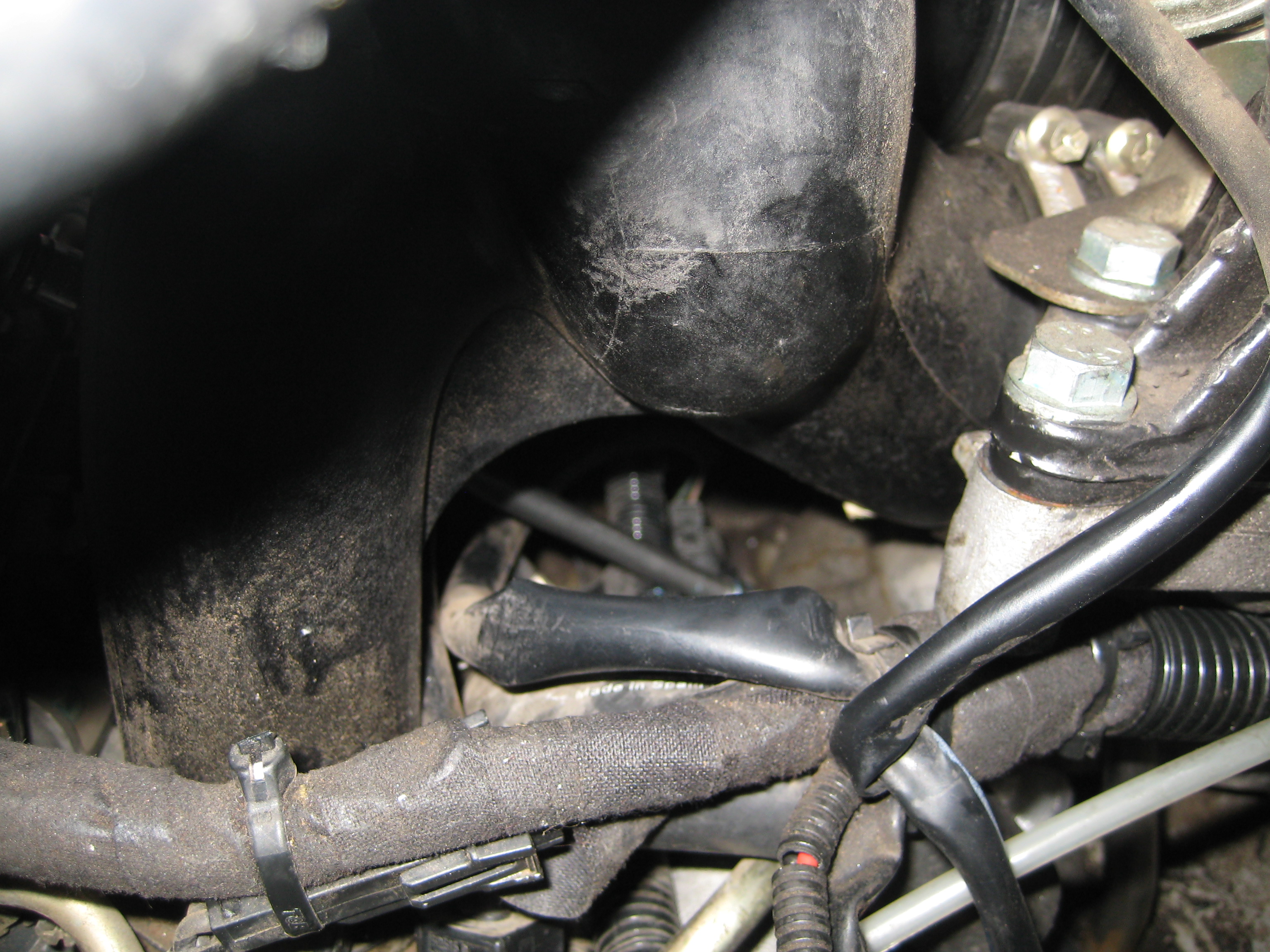

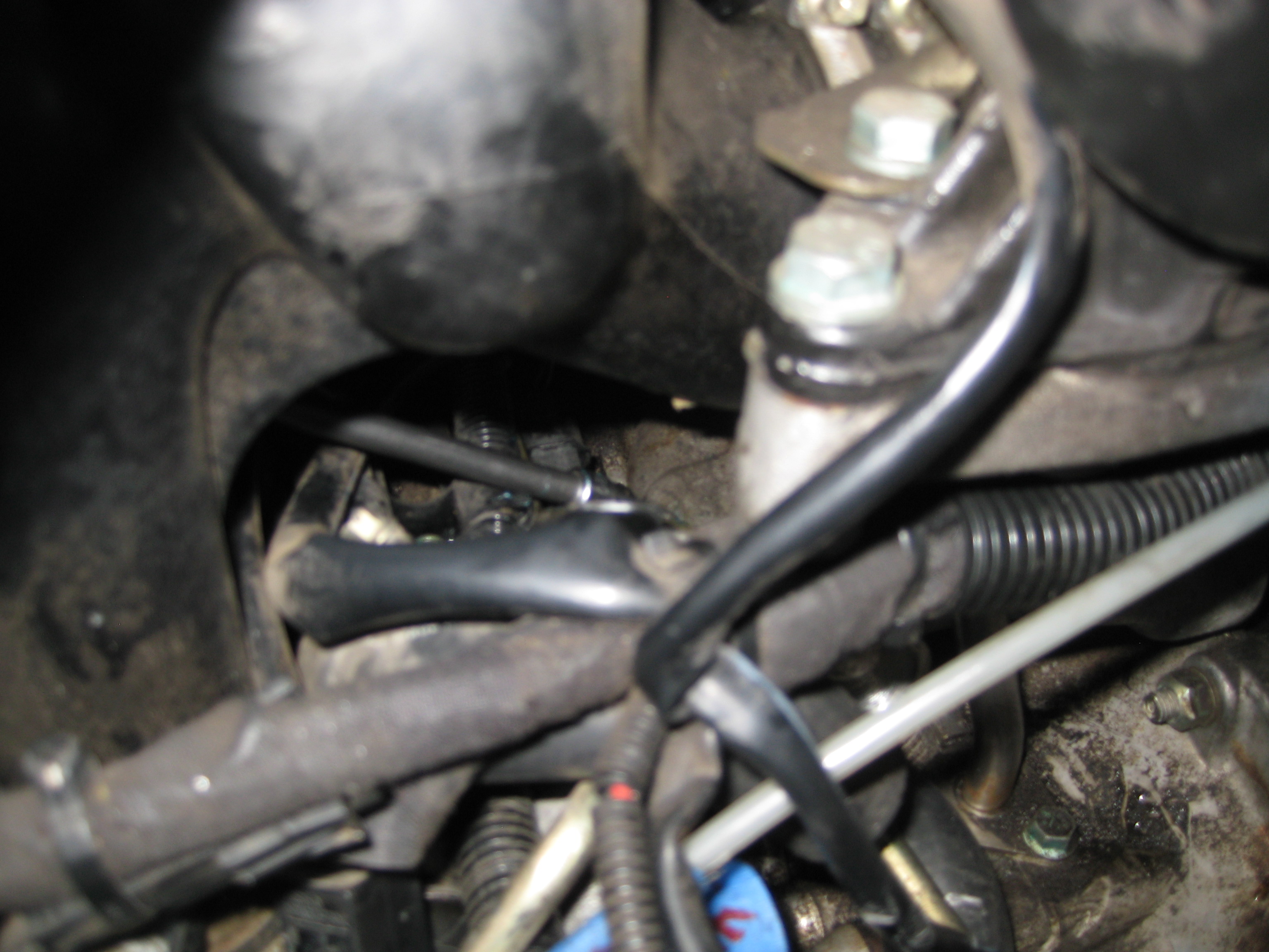

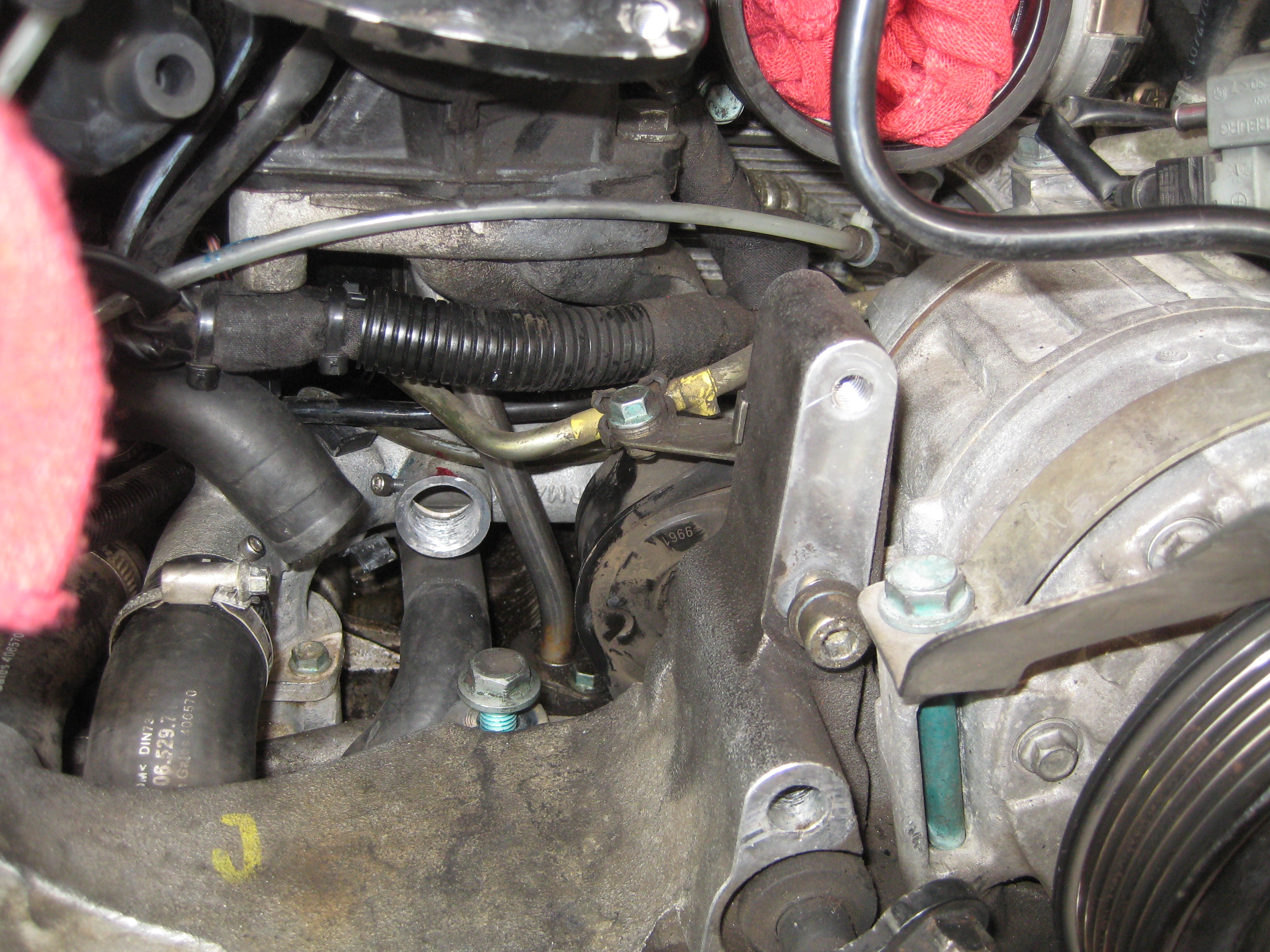

About a month ago or so I had the 90 degree fitting below the oil cooler pop out on me, dumping all the coolant. I posted on here "help coolant fitting" So I followed Steve`s post on Rennlist about pinning his GT3 fittings and as he only had 6 fittings, our turbos have 8. I removed all the neccessities including alternator, compressor, power steering pump and pinned the 6 fittings very easily without lowering the motor. Now for the 2 that are supposed to be a *****! I removed the tensioner brackett on top of the motor and also the 90 degree cast pipe that was connected to the bracket and Presto! the 7th fitting was staring me in the face and with the help of a Ryobi 11" flex drill shaft, I was able to drill, tap and install my 8-32 hex cap with red loctite again EASILY!
Now I was able to see the 8th fitting using a flashlight and I am thinking I can get a drill extention on a staight shot to this fitting. First remove fuel filter and then intake manifold behind air cleaner. Now you have enough room to drill, tap and install screw between the last 2 intake runners on the left side of the motor. Its a straight shot and I did not lower the motor. It was pretty fricken easy! I di not remove the plenum of intake on top of motor

Sounds like a not too difficult project for the DIYer. Are you drilling all the way through or just partially through the fitting? If all the way, are you worried about metal chips? It seems the challenge would be to drill just say 2/3 to 3/4 through the fitting without breaking through, then tapping to that depth. In that case a set screw may be easier to deal with than a cap screw. Good job. Thanks for the report and pics. Maybe a project after I complete my RWD.
Old Aug 26, 2015 | 08:15 PM
mikerosi's Avatar
Joined: Sep 2005
Posts: 511
From: Bay Area,CA
Rep Power: 43
mikerosi is a jewel in the roughmikerosi is a jewel in the roughmikerosi is a jewel in the rough
I am only drilling in 1/2 inch to penetrate the actual fitting insert that is epoxied from the factory. I mark this measurement on my drill bit and tap. Now the drill bit is fluted so the shaving comes outward. also I am using thick grease on the bit and the tap. I then use a thin bottle brush to clean the threads before applying the red loctite BTW this the exact method that Sharkworks uses! Also set your drilling speed to SLOW

I am using a milwaukee electric with the the 90 degree milwaukee fitting and also a mikita 12 volt battery. The ryobi 11 inch flex shaft allows you to hold the drill bit where you want to as the shaft only spins on the inside. I also fabbed up a punch to indent the drill bit location. Presumably the most difficult one (the one on the left toward the front) was for me the easiest. A straight shaft with extentions put me right in the zone. Easy to drill- clean and vaccum often, and easy to tap

This is the same method that Steve used on his gt3 on rennlist. Search pinning coolant fittings with engine in car. I used 1/8 inch hex drill bit and used 8-32 stainless hex cap screws by 3/8 inch long. I also used the right tap with plenty of thick grease to capture the metal shavings! There was one which was at a slight angle and I used a 1/2 inch lenghth for that one (the 90 degree fitting under the oil filter). But as long as you use red loctite there is no worry about leaking

Johnny, I am using a 5/32 1/4 inch drive socket and that fits the 8-32 tap perfectly. Then I use a 1/4" ratchet with correct extentions
