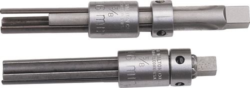

Sounds good just to let everyone know that taps are VERY brittle and is they snap all but impossible to drill out.
I wouldn't even try to drill out a broken tap ( you would need a cobalt bit, and even then the broken tap would break up in chunks) Use a broken tap extractor:

The aluminum castings are way softer than the hardened steel tap. I guarantee you will not snap it off in the aluminum if you continually back the tap out after going forward clockwise a few revolutions. In other words don`t make a straight run without backing the tool out every so often
those are awesome who makes em?
