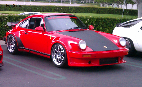

And now I'm in the middle of an engine rebuild, because of a broken cylinder. But, now that its apart, I got to learn some interesting things about the engine. Like it has 964 cams, Carillo rods, ARP studs all around, ported and polished heads, carbon clutch, and lightweight flywheel. Here's a pic of the broken cylinder, which also damaged its piston. I'm having one hell of a problem, trying to find one Mahle 100mm cylinder and piston.
