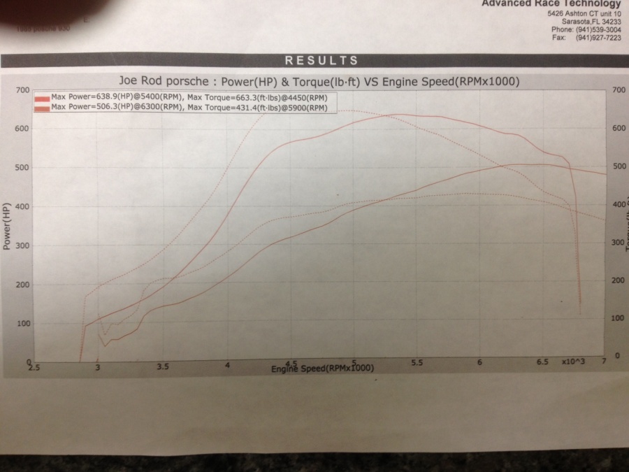

Here are the numbers after tuning. One is at .7 and the other at 1.4 but boost spiked to 1.6 at peak tq.

what gearbox and clutch and pressure plate are you running. are you using stock 930 axles. also the weight of the car? i have a 78 930 weighing less than 2400 pounds with a modified ls7 engine with similar naturally aspirated crank horsepower. i am assuyming that your dyno is rwhp. i do not drag race the car but am interested in your combination.. thanks for any info!
Old Jan 12, 2012 | 09:16 AM
JETJOX's Avatar
Joined: Jul 2005
Posts: 104
JETJOX is infamous around these parts
I'm running a G50 5spd with LSD and using a Sach racing pressure plate, however on some of my higher hp 911 turbo's I like the Spec setup single disc sintered iron, same material used on NHRA prostock cars I believe? The car is weighing about 2595 empty with a very light fuel load. The hp figures are rwhp numbers. I also much perfer road racing and wanted to build a car with good mid range response. The 1/4 mile testing is a very good tuning platform for real conditions. Example tuning with a inertial dyno you can't always duplicate realistic engine loads, so when running on the street the tune always seems to need minor adjusting. My motor was unable to produce the boost levels that I had on the dyno, so hp and tq were way down. A heavier wastegate spring should take care of that? Sorry with the windy response, it seems you're the only person with any interest about such things here?
