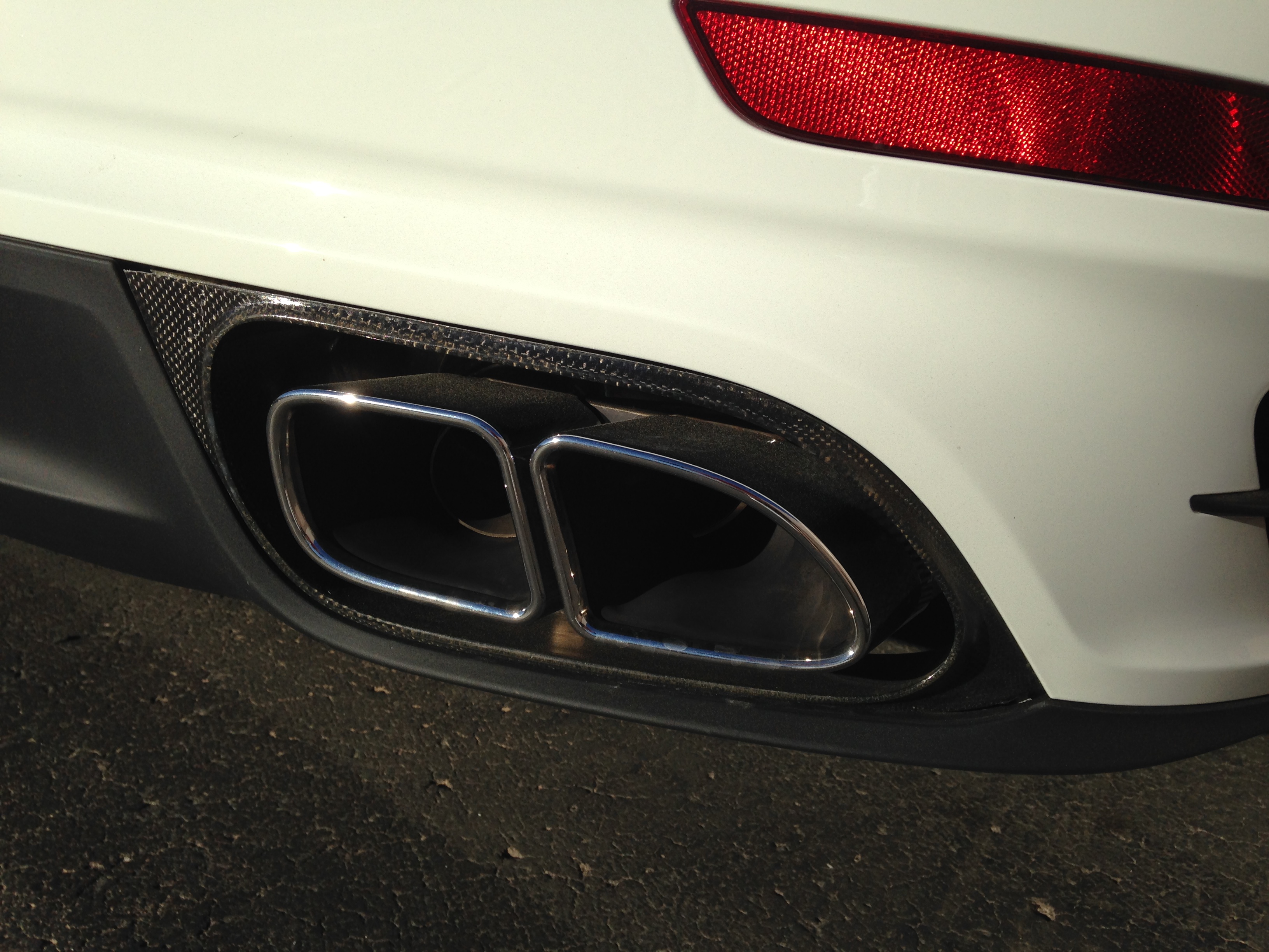

Been driving with the full exhaust system and high flow cats with our headers now for a week. The turbos spool up so fast and the power is noticeable on the butt dyno. There really is not any drone which is nice especially since without Sport Mode on, the car will run in 7th gear at 1700rpm at 40mph!
Been playing with some other carbon fiber stuff here. Here is a first article carbon fiber exhaust surrounds. Thoughts?

Old Mar 12, 2014 | 10:19 AM
  #38
XLR82XS's Avatar
Joined: Jan 2004
Posts: 5,707
From: SW FL
Rep Power: 390
Those are nice.
Old Mar 12, 2014 | 11:51 AM
  #39
Vic55's Avatar
Joined: Nov 2004
Posts: 856
From: THE Orange County
Rep Power: 109
Vic55 Is a GOD !Vic55 Is a GOD !Vic55 Is a GOD !Vic55 Is a GOD !Vic55 Is a GOD !Vic55 Is a GOD !Vic55 Is a GOD !Vic55 Is a GOD !Vic55 Is a GOD !Vic55 Is a GOD !Vic55 Is a GOD !
I would hope for a full carbon diffuser... on the Turbo S the pipes are dark and the carbon fiber gets lost (small piece)
