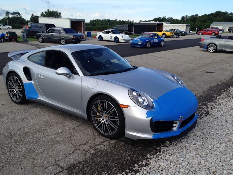

I thought I'd start a thread for those interested in tracking (or who already track) their 991 Turbo (and Turbo S). I have a 991 Turbo and have four track days in it so far, with a couple more coming up within a month. Here are my experiences and thoughts, for what they're worth.
Preface: My previous track experience includes a McLaren MP4-12C and a 997-2 911 GT3. I use my 991 TS for daily driving and as my primary track car. Since I do more daily driving with it, I'm not inclined to change any of the car's settings or alignment to optimize it for track use (yet). I'm not an expert driver on the track... but I do have a LOT of fun, as often as I can.
*** This car is an awesome vehicle at the track. When learning it, you can get incredible performance even with the stability control on. However, you will wear your front tires a little more because as brilliant as the SC is, it will keep you from the kind of rotation you occasionally want when exiting a corner. The trade-off is you're a lot less likely to over-rotate and spin (and if you do misjudge your line, your slide off the track is likely to be much more controllable, given the forced understeer of the SC).
*** This car seems to eat tires more than my 997-2 GT3. Given nearly identical tire sizes, I think this car holds better, turns in better, and is a little less likely to spin than my GT3 was once you've gained the confidence to turn off the stability control. During the periods following my failures to manage the car's post-apex rotation, I found the departures were predictable, and it's ability to go four wheeling through the grass quite acceptable. :-)
*** At least once per track day, the car throws a PDCC fault in Sport Plus (track) mode. When that happens, it drops you back into Normal mode and the fault won't clear (as far as I know) until you've turned the ignition completely off and back on again. That's kind of an annoying session interruption. It seems more likely to do this if you're tracking with SC left on, but I've had it happen with SC both on and off. I don't yet know why it's doing this. It's possible that it's happening during over-steer/drifting, and my dang car feels strongly that I should be keeping it pointed more in the direction of intended travel, but...really, how fun is that? :-)
*** After a track day, my PCCB brakes *really* grind horribly, and for a day or two of normal driving feel rough and sound noisy. Then they smooth out again and are good to go. This started after my second track day; I know not why.
*** Threshold braking down from 150mph in this car is a bit hairier than it ever was in my McLaren 12C or 911 GT3. It really feels like this car's systems are working hard during max braking to keep it pointed in the right direction. That said, this car's ability to slow down FAST is simply amazing. That also makes it a bit hairy when someone's following you closely, because you're pretty sure they can't slow down as fast as you can! The good news is that there aren't many other cars out there that will be close behind you at the end of a straightaway. :-)
*** If your car comes with the PAS (Porsche Adaptive Safe --adaptive cruise control), you're going to want to turn that OFF before heading out on the track. You'd think putting the car into track mode would do that. It doesn't. Few things are as disconcerting as having the car take over braking as you scream into turn one, simply because your Porsche's brain thinks coming up to 10-15' of separation on the car ahead of you, while going 90 miles an hour, is cause for alarm (and PAS intervention). You have to drill down into the settings to turn it off. Also turn off the vehicle's parking assist, for the same reason...
*** I specifically got a launch version Turbo S with the 5-lug wheels, because I didn't want to screw with changing CL wheels at the track (or at home, for that matter!). My GT3 had the CL wheels and I found them restrictive--I didn't want to change my own wheels at all. So it's been a bit frustrating to find that no one (Hoosier, Nitto, Hankook, etc) seems to be making a pure track tire in the sizes this behemoth needs. I've yet to find out if anyone's figured out whether there's a set of 19" rims available that will clear the ginormous 16" disks of the PCCB system and, if so, what the appropriate wheel and tire sizes would be to mirror the OEM setup closely enough to avoid confusing the car's finely tuned wheel management systems. I'm also wondering whether the increased traction that track tires will give will confuse the PDCC and rear-wheel steering....I guess we'll see!

*** If you're on a track that tends to abrade tires (like one of those I regularly run on), taping your car up will save you a LOT of post-track clean up time. I use standard blue painter's tape. Because you're car is very likely faster than most those on the track, time spent following others waiting for a point-by or chance to pass is time spent potentially collecting rubber marks tossed up by the car ahead of you. Helpful note: Those big flared hips will also collect their share of rubber marks. Taping up those rear scuff pads as well as the nose will save you lots of clean up time. (This was never really an issue in my black GT3, but the first time I took my rhodium silver 991 TTS to the track I received a painful lesson on its propensity as a rubber magnet. I think it took me about 2 hours with bug-n-tar remover to get my car clean again!)
(As for the gasoline range, I think that's just a 911 thing through the years; my 997.2 GT3 had the same short range. It could do two 20-minute sessions, but not two 30-minute sessions. So, about the same as the 991TTS.)
I use painters tape as part of my track-day prep. It tends to save a good 1-2 hours of clean up time afterwards!
