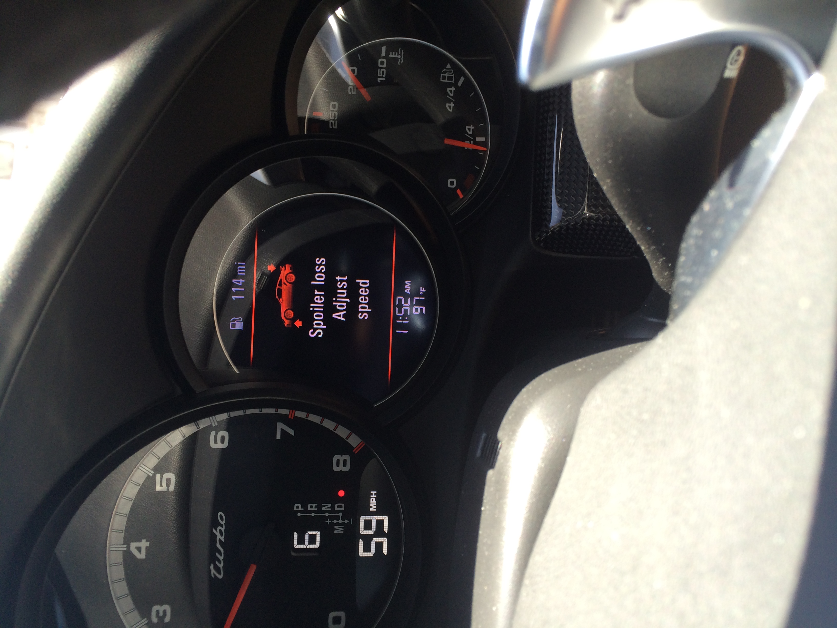

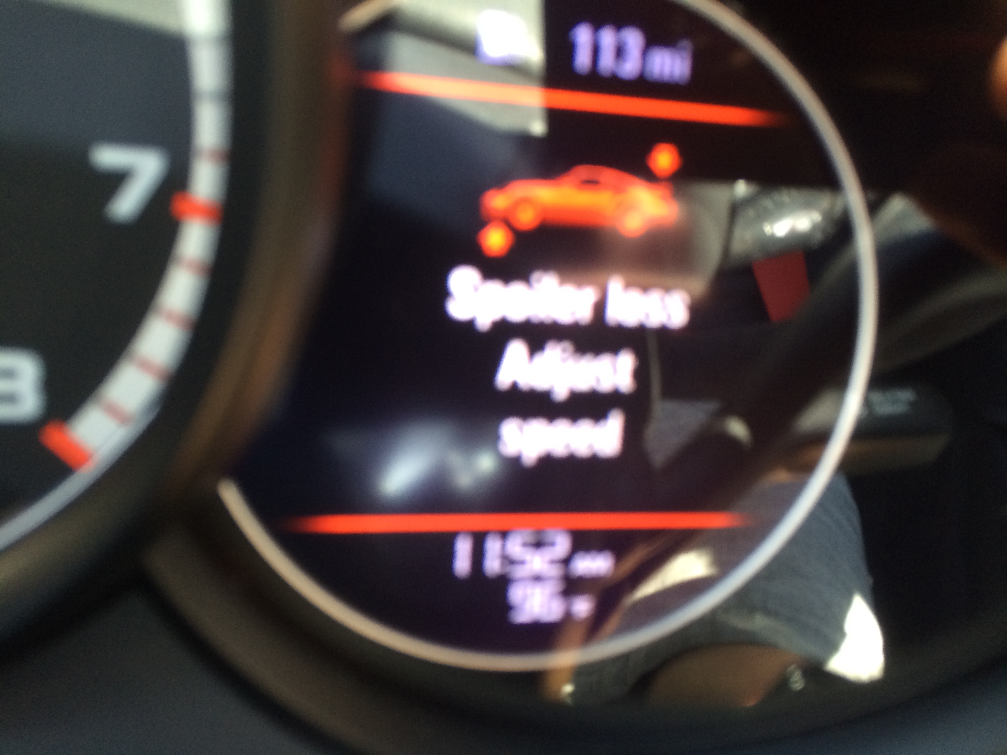

i got this error message on my car today. The spoiler off message ... anyone had this problem before ? thank you

I got this many times before. Usually goes away when i turn the car off and on again.

I got this message before 2 weeks ago . the dealer told me that I have to update the software . I went to them updated the software but it didn't work and now they have ordered a new complete front spoiler with the mechanical parts . This is a common issue in the new 991 Turbo/s and you have to try to turn the car off and on again if it didn't work then do the software if it didn't work either so the worst scenario is to diagnose the car and check which part that have to change . Mostly it is because the front spoiler .
i know it's not fun to drive the car without the spoiler and the message is annoying . i hope by updating it will go . but first turn it off and check if it didn't go you have to contact your dealer .

my rear spoiler is not going up as well... not only the front spoiler .....

The front spoiler and rear spoiler are connected to each other . If one of them doesn't work the other will not . I told you I have the same issue that you have and when speed up the message will show on the screen .

3 times same issue

i was thinking to disable the front lower spoiler cuz it make the car too low to drive ......
