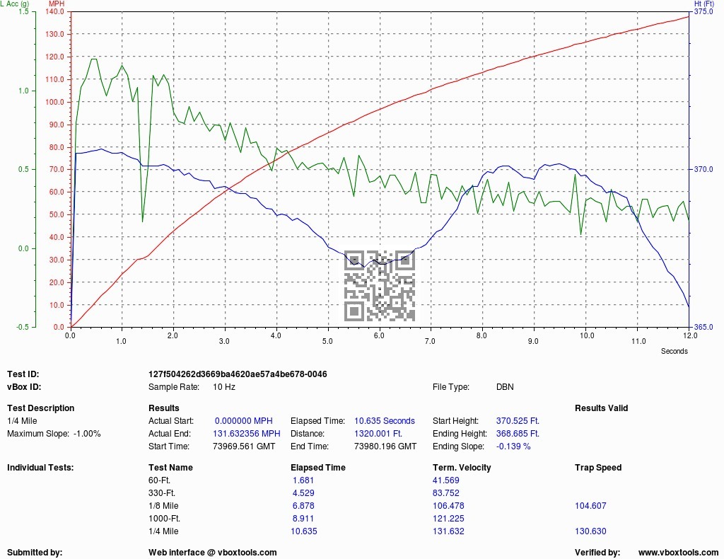

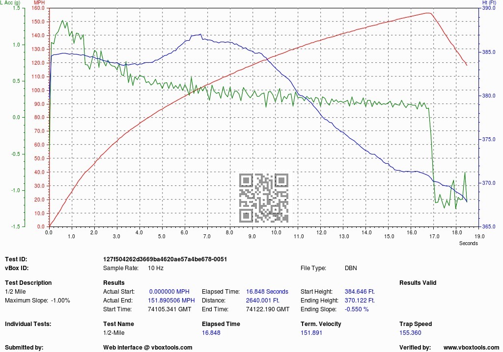

Here are Vbox numbers I took just the day that I finished posting on this thread just to prove my car didn't get de-tuned in a month or so. The half mile top speed was 157mph and I started slowing down just before the end of it. I don't have a good measure of distance when I make the runs so I have to judge by speed and I was getting close to the end of my road and had to slow down just a tad early. The trap speed was still 155 even though the terminal speed was down to 151 so clearly, the car probably could have hit 158 or even 160 in the full half mile if I hadn't braked early.
In fact, my quarter time on the day I got the car back from adding the mods was 10.571 @ 129.54 with a 60ft of 1.59 and three weeks later it was 10.65 @ 130.63 with a 1.68 60ft so the only difference in ET is the 60ft but the trap speed is 1mph faster three weeks later so you might conclude the car got faster. No de-tuning there. When someone offers real proof then we can discuss it, until that time it's just a baseless claim. My data show my car got faster with time, which counters the claims made about the ECU adapting the module out.
