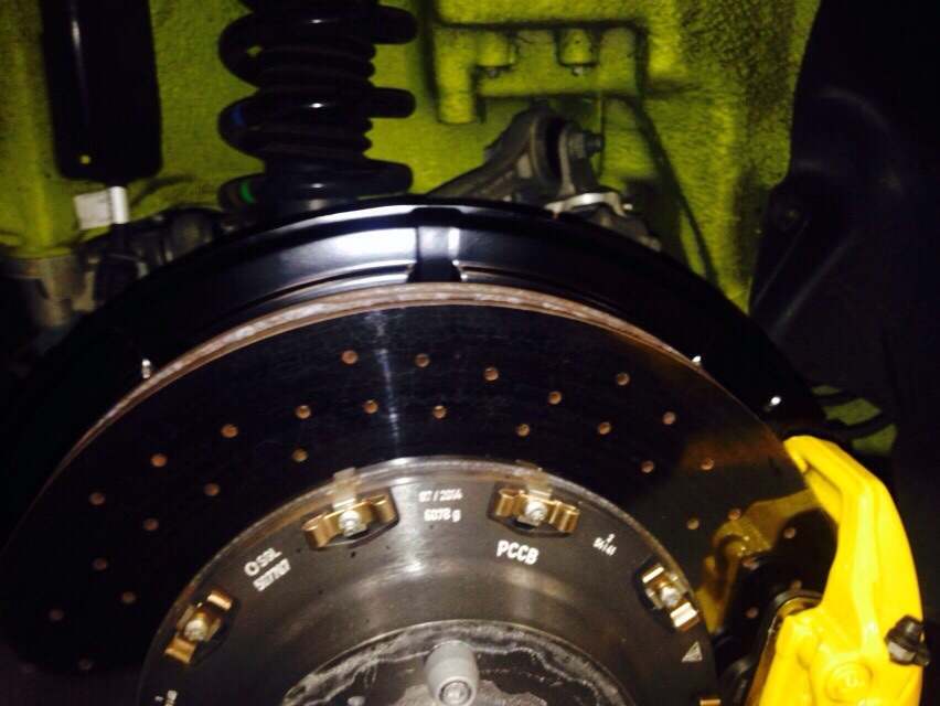

Also remember the rear brake discs if Ceramics , have the disc shields which sit behind the disc and adds another 2-3cm ....I had to have these cut down to fit a set of light trackday wheels ...
Sorry poor quality pic of the modified shield

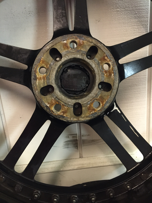

Made by Zone Wheels
