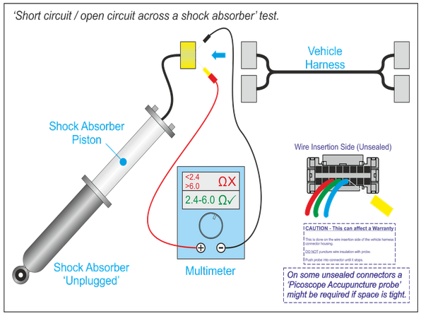

Thanks to the docs that @UltraMarine posted, I found the actual procedure to test dampers:
Again, the 2 suspicious dampers didn't return any Ohm readings, whereas the "good" dampers returned a value within the range.
So my next step is to replace the 2 rear dampers (of course the more difficult ones to replace) and retest.
