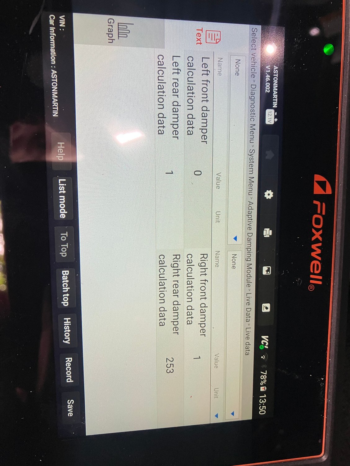

I hooked up my scanner again and I noticed a couple of interesting paramaters.
First, the "calculation data" for the right rear damper is at 253, when the other 3 dampers are at 0 or 1.
I tried reconnecting the "old" damper but the result is the same...

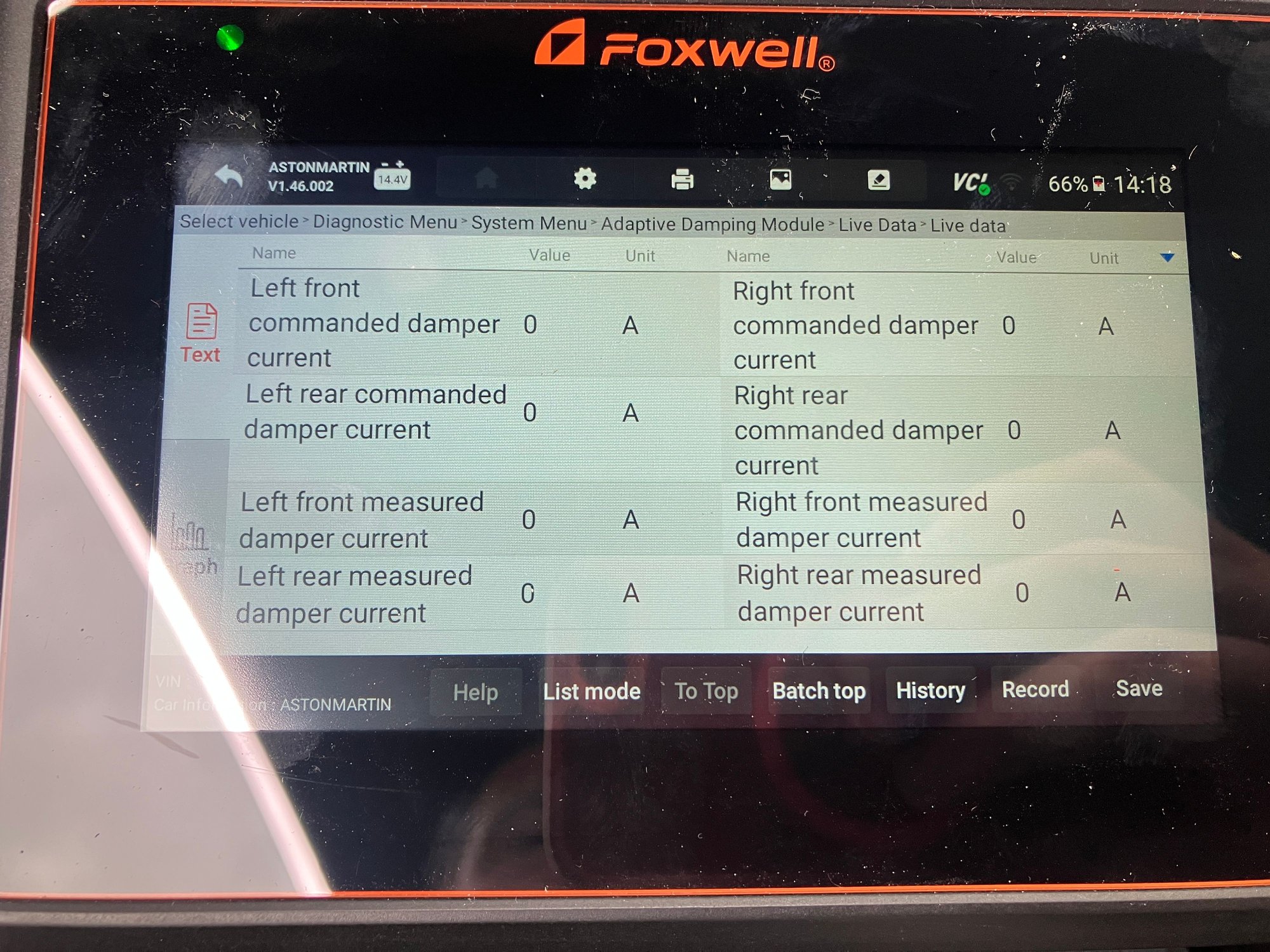

Then I looked at the measured and commanded currents to all 4 dampers, and all 8 values remain at 0, even when I am driving.
Now I am starting to actually suspect the ADS module...
Did I miss something? Is there a reset procedure? Or a programming?
