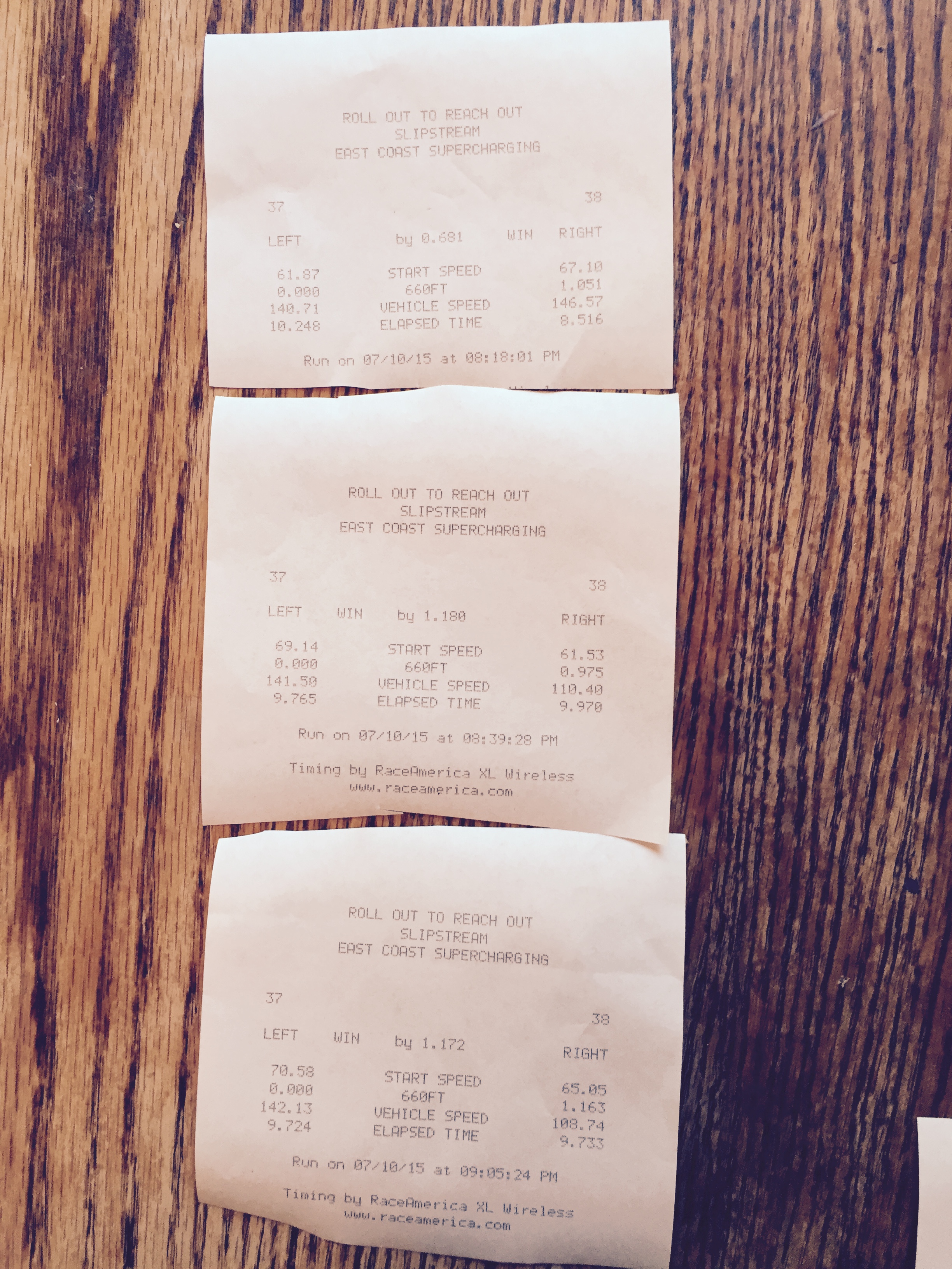

Here are my time slips from my three roll races of the 991 TTS vs. my E63 S.
The E 63 was car number 37.
The 991 TTS was car number 38.
Pretty embarrassing for a $200k modded 991 TTS to be beaten two of three times by a giant tune only and free flow muffler sedan.
To be clear, the trap speeds on the Porsche in the second and third runs are wrong but the ETs are not. Slipstream had timing system problems all day.

See video at 3:23. My E63 S beats my 991 TTS in both's second or third run after lunch and a one hour cool down.
