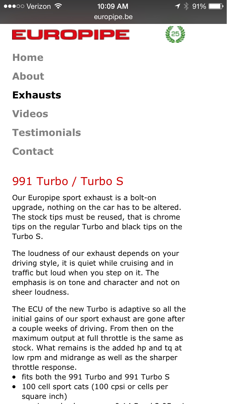

Agree 100 percent. ECU need to be reflashed to account for better breathing. And the scrupulous aftermarket exhaust vendors, like Stef from Europipe, say so publicly on their website.
