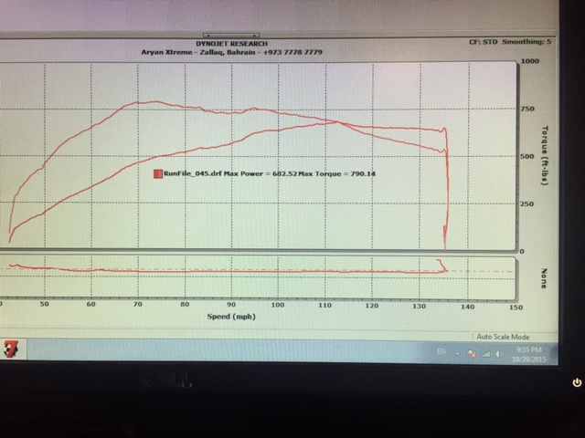

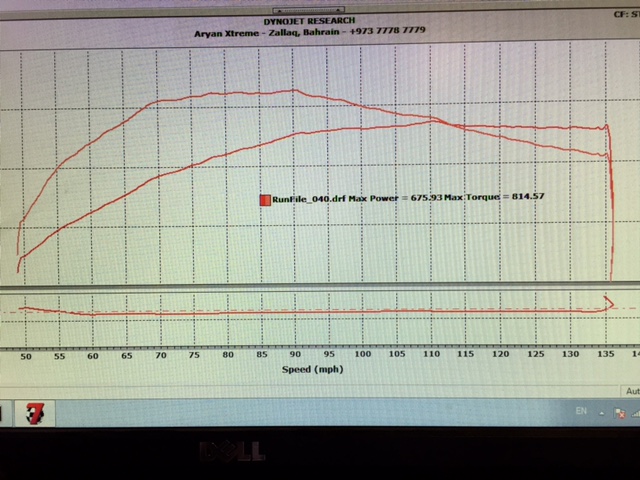

going to the track today, the issue i am facing is i have allot of clutch slipage based on the logs and offcourse very noticeable in the car. decided to take the car to the dyno and see whats going on since we did fine tune the car on the street.

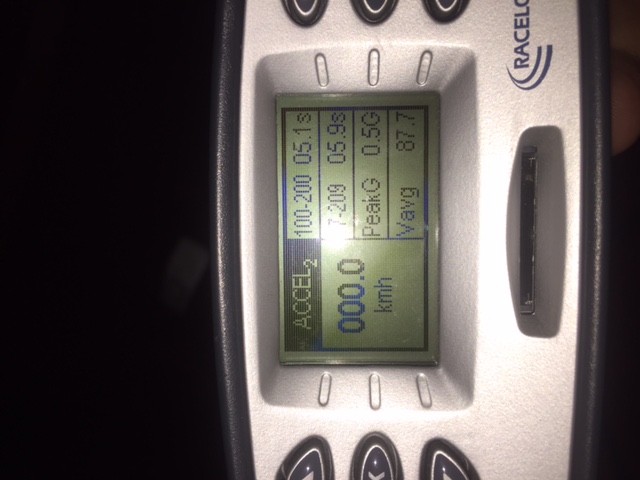

ran 5.1 (100-200 ) road was actually uphill car should do 4.9 i guess proper road and traction.
after dynoing the car we noticed the tq was extremely high probably causing me allot of slippage and tuner was trying to drop the tq down to help avoid slipage.
car made 675awhp and 814awtq after re tune 682.5awhp and 790awtq
i am going to try to run without launch control just on idle to see if it holds.
vbox on the street car trapped 140.8mph without launch control weather was over 92 degrees

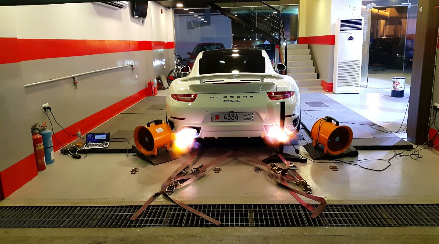

I love how it looks like the dyno is in the building's lobby.

yes i went 9.9 yesterday although i have major issues with my clutch slipping and the weather was almost 100 degrees with head wind in the track. my highest trap without launch control was 141mph and with launch control 138mph. i was doing back to back runs with a maximum cool down of 5-10 mins.
well hopefully when weather cools down and we can figure out how to drop the tq to reduce slippage car should run faster.

only emre (esmotor) can answer that but we do have different tuners. based on my tuner my car is maxed out cant make more power based on fuel system and off-course clutch. we were actually tuning the car to actually reduce the power and tq down low to help with the slippage.
we will have to see a full esmotor 991tt with all the mods dyno numbers to see whether this is actually the limit of the cars fuel system or not.
Based on my knowledge i actually do have one of the highest hp 991TT thats been dynoed without NOS.
