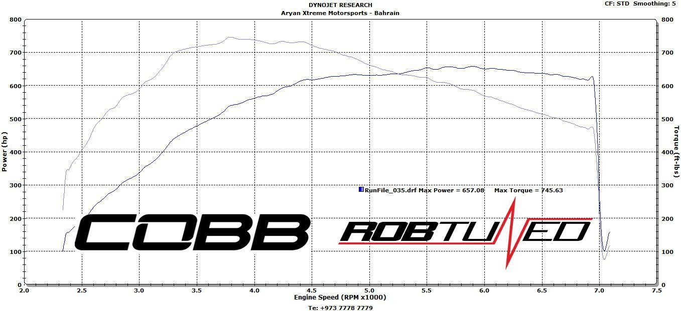

Hey Guys,
One of our Protuners, Rob from Rob Tuned (http://robtuned.com/) has been in Bahrain tuning cars and just finished tuning this setup! I wanted to share as I have yet to see a 991 make more power (or torque) than this! All custom tuned using the Cobb Accessport! Rob did a fantastic job! Notice how smooth the curve is!
This was made at only 19psi of boost!
The following is the setup used:
Exhaust
Meth Injection
ES Motors Modified Turbos
ES Motors Intercoolers
Stock Motor
Now Rob did make more power but at around 675whp the car was starting to lose fuel pressure.With the Accessport we have the ability to monitor the high pressure targets and actual fuel pressure values so we can safely tune cars to the limit and know when to back it down if need be. They are looking into an upgrade for this now. Great results as he has managed to find the limit of the stock 991 fuel system!
The car will be getting drag raced very soon so I will try and keep this updated with info.
I have also attached Rob's protune before the turbos went on. Car made awesome power on the stock turbos!!
Thanks for reading everyone have a good day or night!
-Mitch

Oh and how much whp and wtq will that translate for a Mustang Dyno?
Roughly 581hp and 659tq mustang

I wonder what stock 991TT make on that Dynojet.
I would imagine around what other stock ones make so around 450hp and 480ft/lbs or so.

Hello Mitch,
Just to make small correction on the mod list, this car has also our intercooler upgrade kit.

thanks for the post.
The car stock made 416awhp on the same dyno
we actually made 661.82awhp and 755tq after that run.

excellent tuner , and cob was a great investment..
hopefully tomorrow with a few tricks we would make more power.
will keep you posted.

Wow, Awesome numbers! Sorry if I missed it but what kind of gas?
Wow! That is at about the pdk's limit. Getting any slippage?
