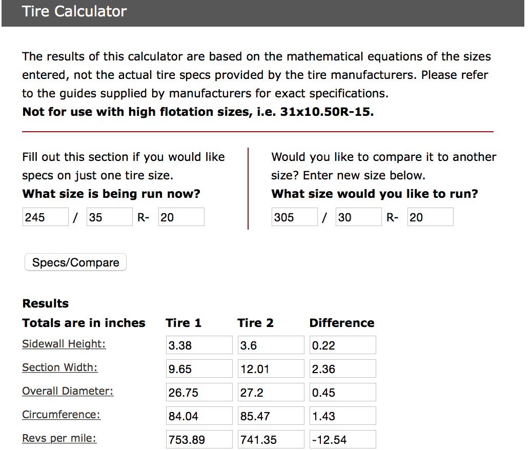

The difference between rolling diameters on the GT3RS with the 20/21 would probably detonate the AWD transfer case. Vendors have looked for front tire solutions to balance it out and havent found any. I'm under the impression (but dont know for a fact) that the GT3 wheels allow tires that are more in line with the 27.1"/27.4" F-R difference that comes stock.
The 27.1/27.4 you're getting is the F-R for a GT3RS?
Because the GT3 and Turbo S both have a 27.2"/26.75" F-R differences stock. They both run a 245/35/20F & 305/30/20R P-Zero.
Based on my calculations, there should be no problem with the AWD transfer case as the rolling diameter and the tires size are exact for the GT3 and Turbo S, the GT3 just has wider tires (.5 inch) and a more aggressive offset. Correct?
Name:	Screen Shot 2016-02-21 at 2.33.45 PM.png
