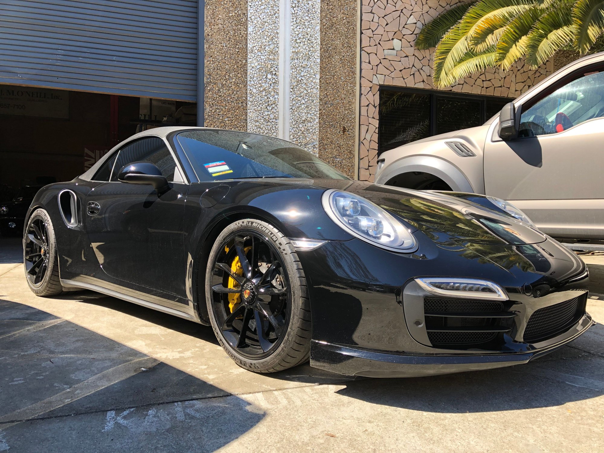

The GT3Rs wheel is 9.5" wide with the same off set as the 9" stock TTS wheel. This means that it its 1/2 wider than the stock version. Given its the same offset, it distributes the increase in size by moving the wheel 5mm close to the strut tower and 7mm outward at the fender. My take is that looking at it from the outside it will fit perfectly. The 5.3mm movement towards the strut tower is tight. It may not work - its just that close.
Hope that this helps...

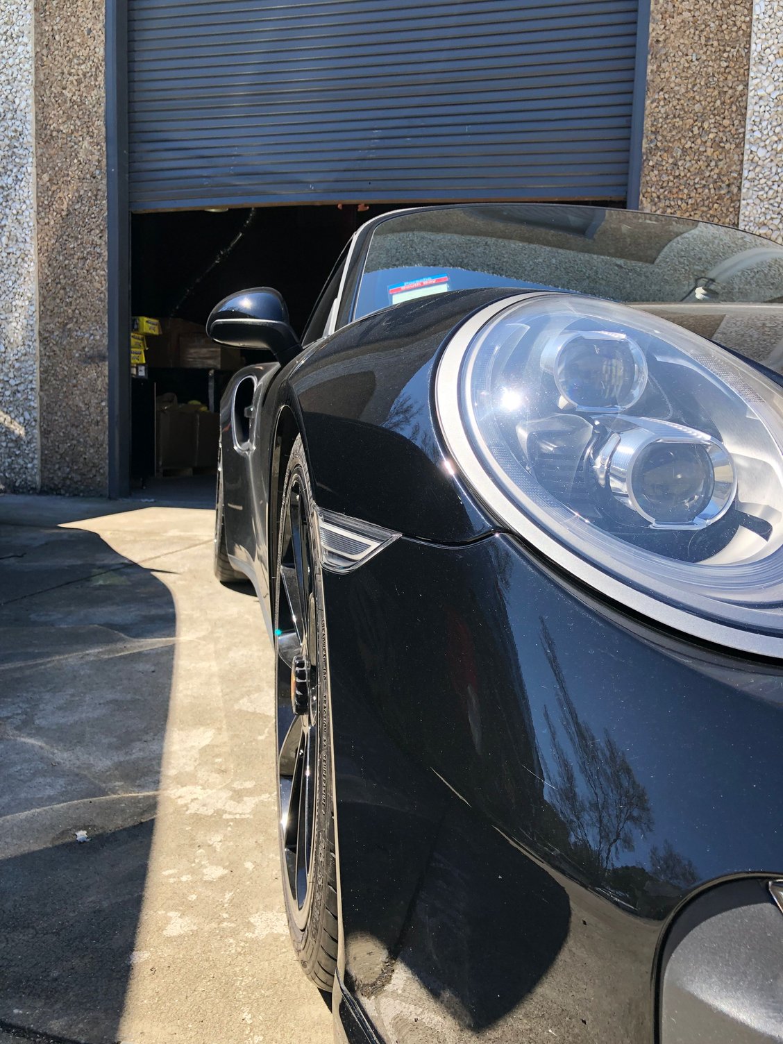

I have it mounted. GT3 wheels fit perfectly. GT3RS wheels should work but not with the tires that they normally recommend. They wont fit with the TTS configuration.
Here are a couple of pics to show fit - car is lowered on H&Rs:
