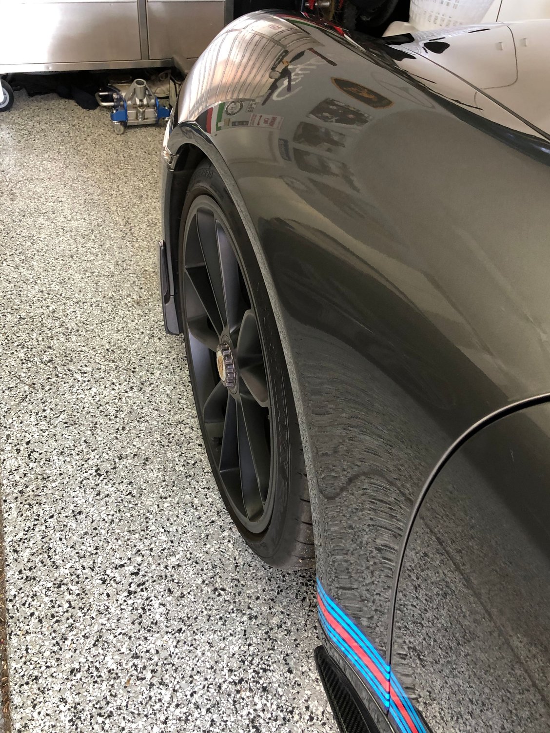

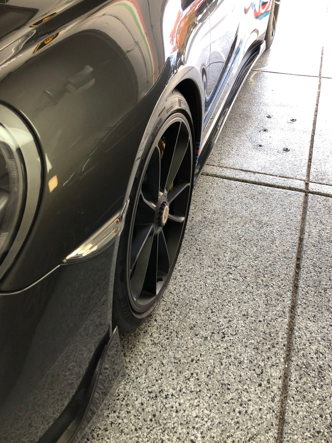

I may be testing my own theory soon: I am trying to locate a set GT3 RS wheels and plan to try them out on my H&R lowered 991.1 Turbo S! I don't see any reason why they wouldn't work perfectly since my Signature rears are the EXACT same offset and the front offsets are 5mm less, meaning less aggressive fitment... I know the GT3 RS rears will work perfectly on my H&R lowered car; my only concern is the inner clearance of the GT3 RS front wheel.
GT3 RS wheels;
GT3 RS front: 9.5x20 ET50 (5mm more outter fender clearance than Signatures)
GT3 RS rear 12x21 ET48
(Recommended tire fitment for GT3 RS wheels on Turbo S):
front: 255/35/20 or 265/30/20
Rear: 325/25/21
Signature wheel fitment:
21x9.5 ET45 255/30/21 (+1 sizing and 5mm closer to fender than GT3 RS)
21x12.5 ET48 325/25/21 (exact spec for GT3 RS)
no rubbing whatsoever!

To your point; I'm a little concerned about the inner clearance on the front wheel myself. To run the GT3 RS front means that the wheel will be 5mm closer to the strut.... Not sure if I have that much room available... I hope to find out soon!
