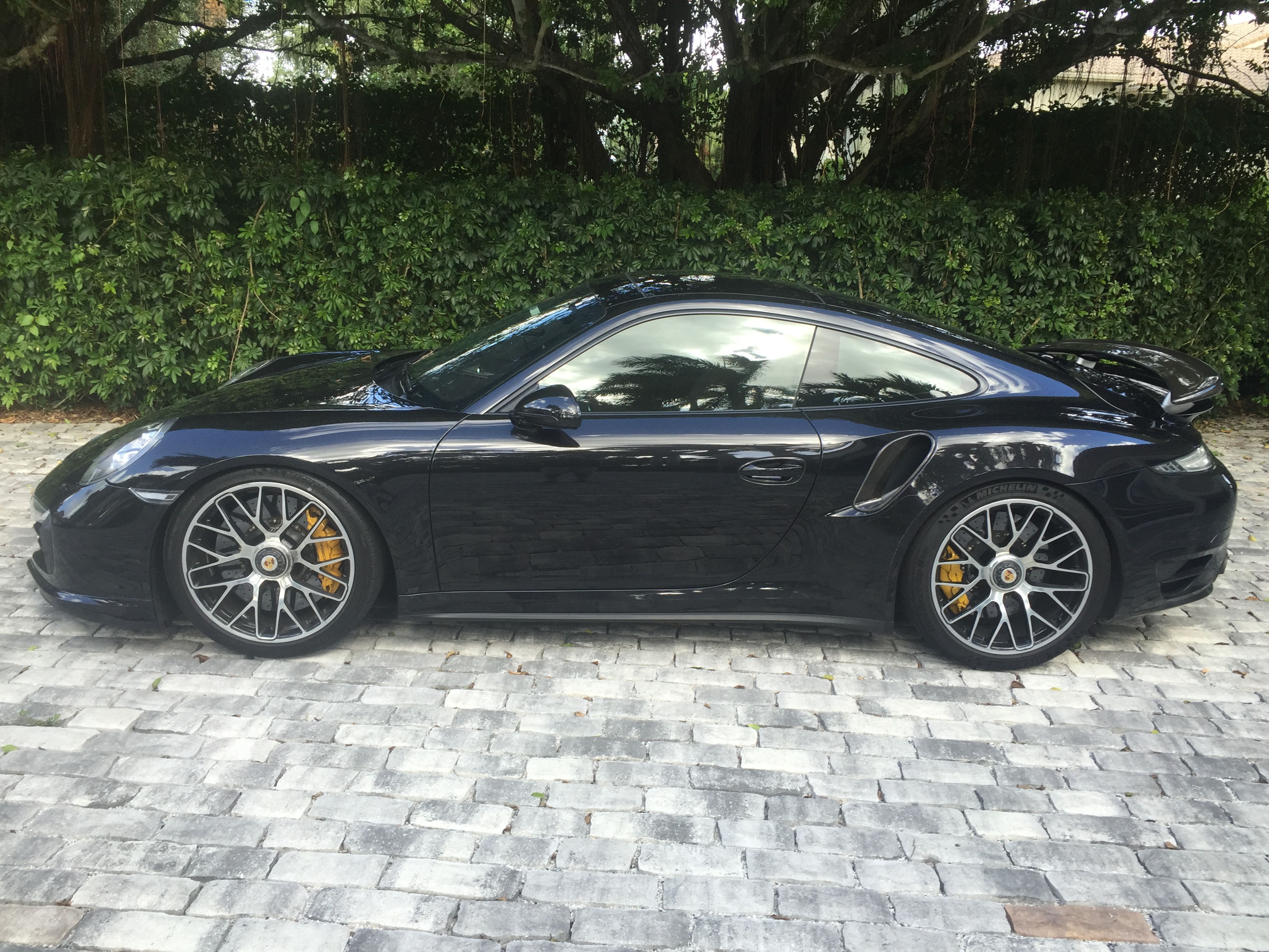

I have no issues. Also the rear on the 991.2. TTS are now 12"
I am also lowered
