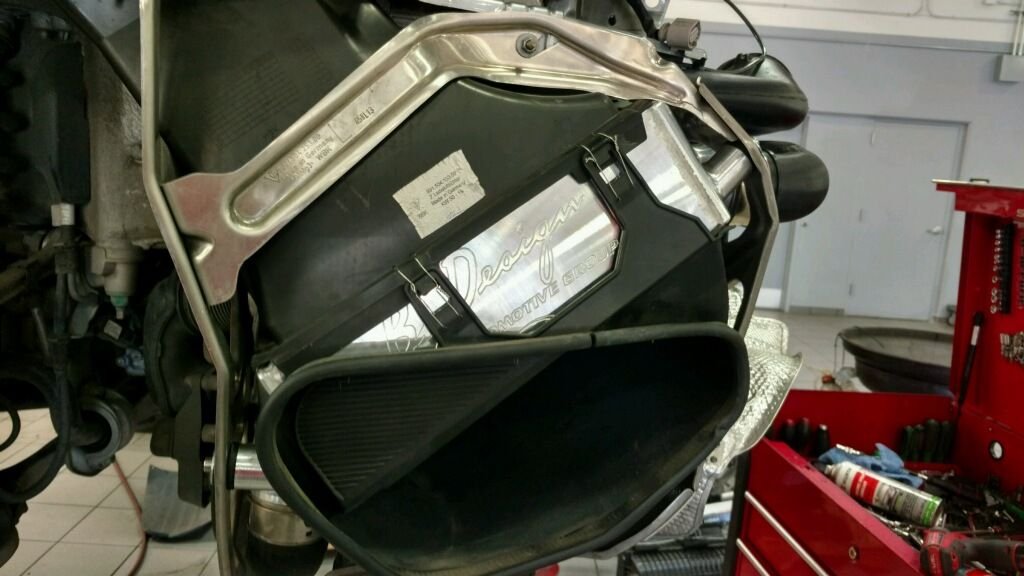

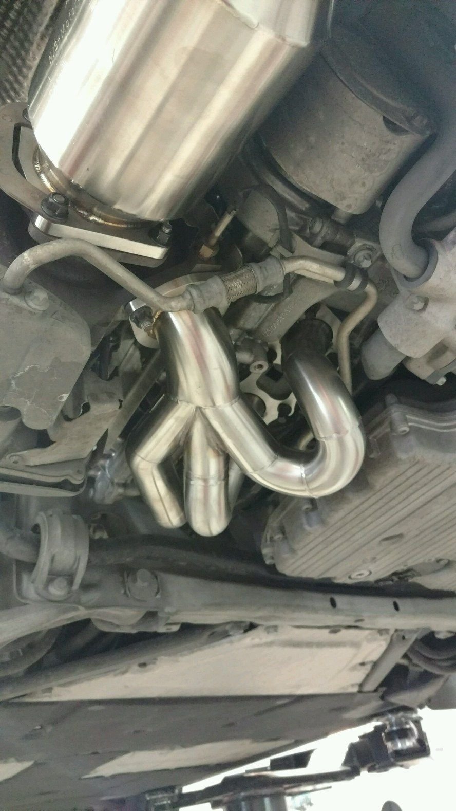

Okay, okay....Finally got the bolt-on portion of my Stage III installed. Boy o boy, this thing sounds mean
So far, I have installed the full Kline Exhaust, headers and hi flow cats. Also, By Design IC's and air filter. I do have the Cobb AP, but have yet to install as I wanted to see/feel the power/sound of the bolt-ons first before adding the tune.
My install was done at my local P Car dealer (Porsche of Reno). Jess my tech did a wonderful job and Sam even made himself available to Jess for anything he needed.
Here are a few pics of the parts as they were installed.
