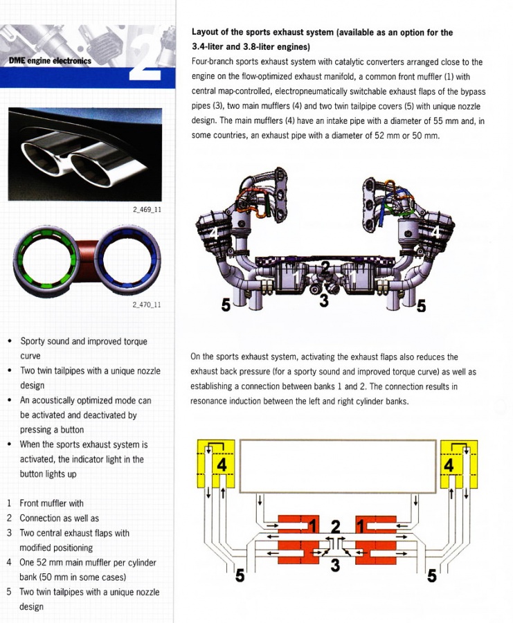

Originally Posted by Felix_Kline
that pulse of the left bank merges nicely with the pulse of the right bank. that's a great animation but isn’t that for a 2 cylinder boxer n/a engine ?
i think that on a 911 turbo the 3 pulses of each bank are smashed into pieces by the turbochargers so the flow must be much more homogeneous. must be the reason why a turbo engine sounds soo much quieter
seems like porsche uses the x on the 991 pse for another reason. half of the 400 hp is routed through the x so both banks get connected. quite something different than pushing 600-800 hp though that x
